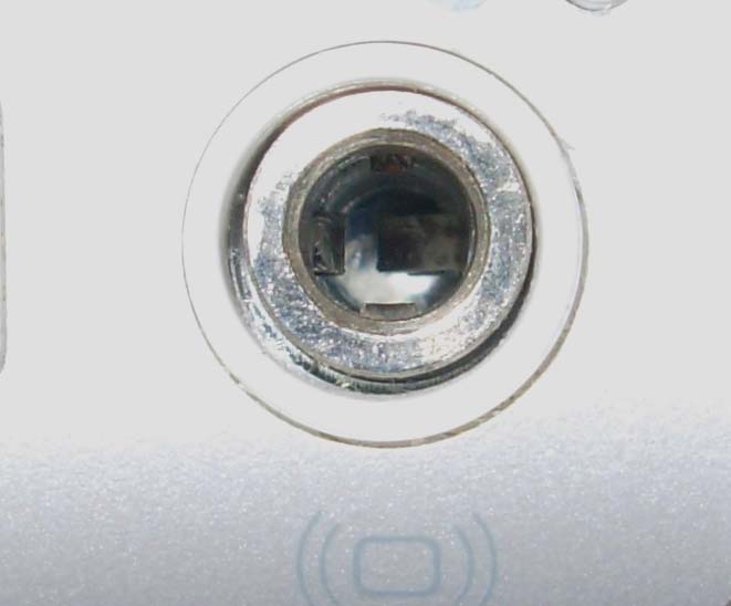

I wanted to upload this pic for everyone else. If your internal speakers say "headphone" your jack tabs are open.
The tab on the right should come completely over to touch the one on the left to close the circuit. Trying to bend it over with a small hook pic is not really effective as it needs to be bent PAST the point of contact so it will go at least that far to create pressure. You'll have to pull the whole book apart and desolder the jack, remove it and pull it apart also.
If you really want a quick fix, cut a jack plug off your old headphones and use a volt meter to see which two wires those two tabs are and jump them together on the cut headphone plug.
