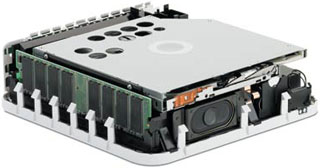

the only thing i know it that the mini has a small little tiny speaker inside to play the startup chime noise ...
never heard of anybody who played itunes through this little speaker
and its not software related as then you would have the same effect on external speakers too
here you see
it its this oval shaped thing under the optical drive so in reality its even covered up by the case , so it has to sound muffled
a option would be to drill some holes in the case in front of the speaker so soundwaves have a chance to exit the case
