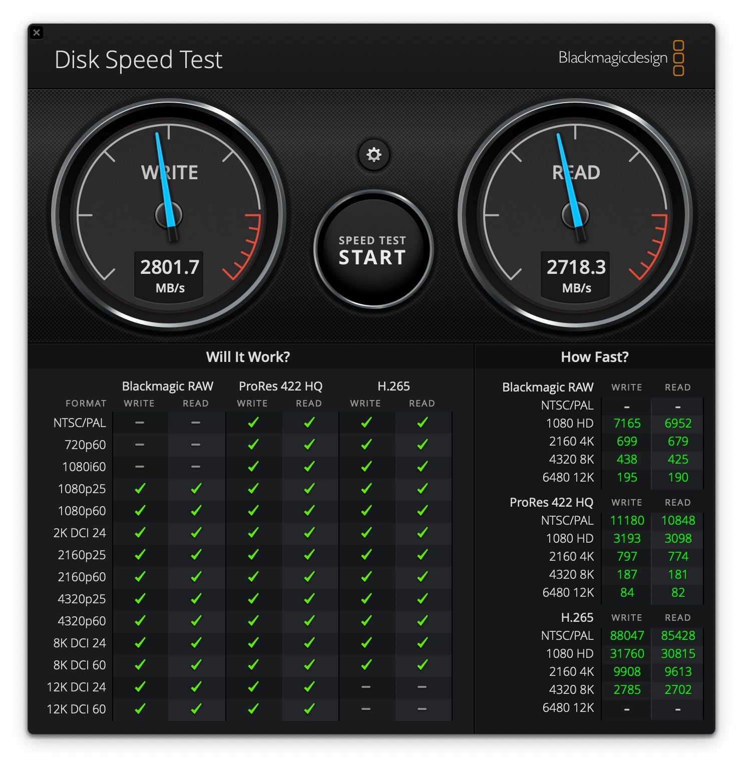

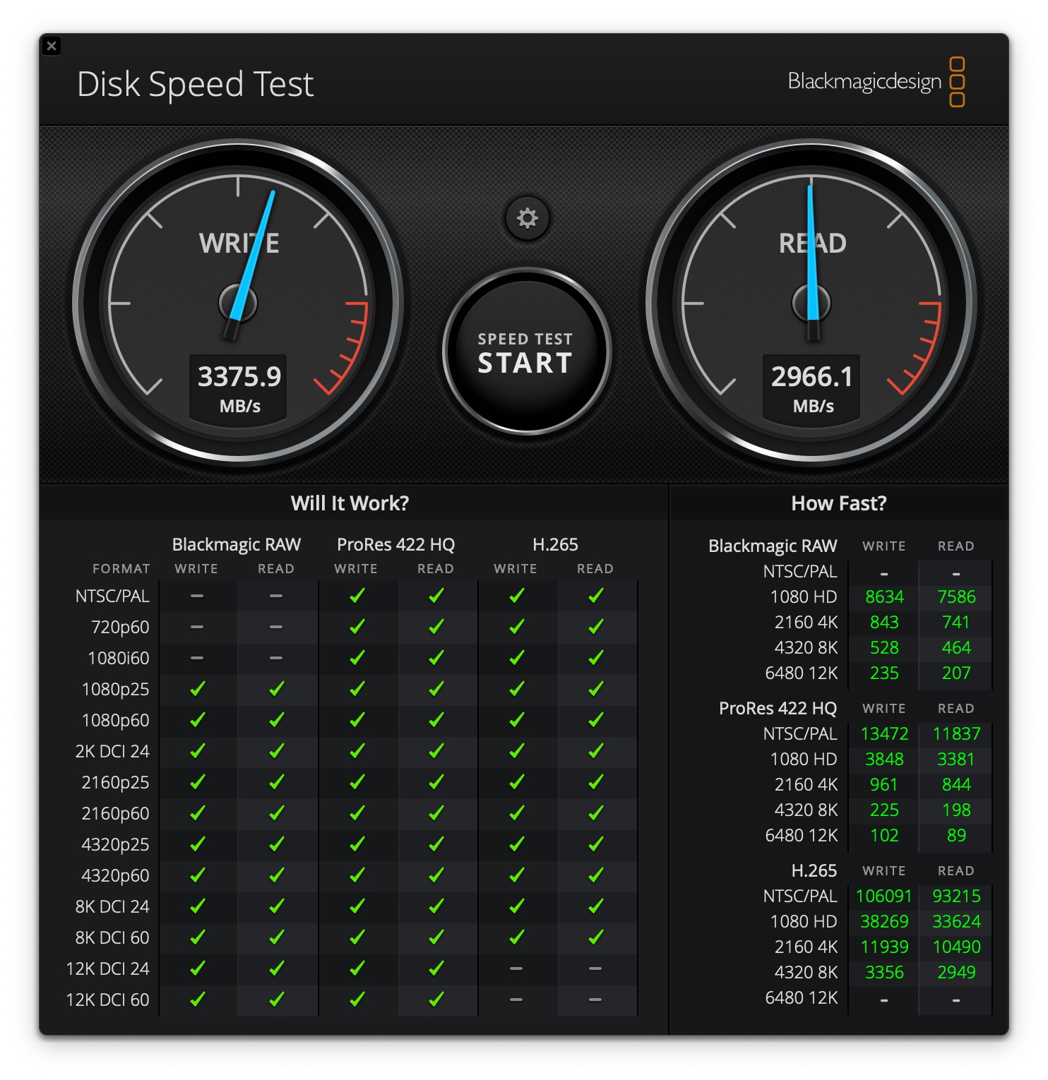

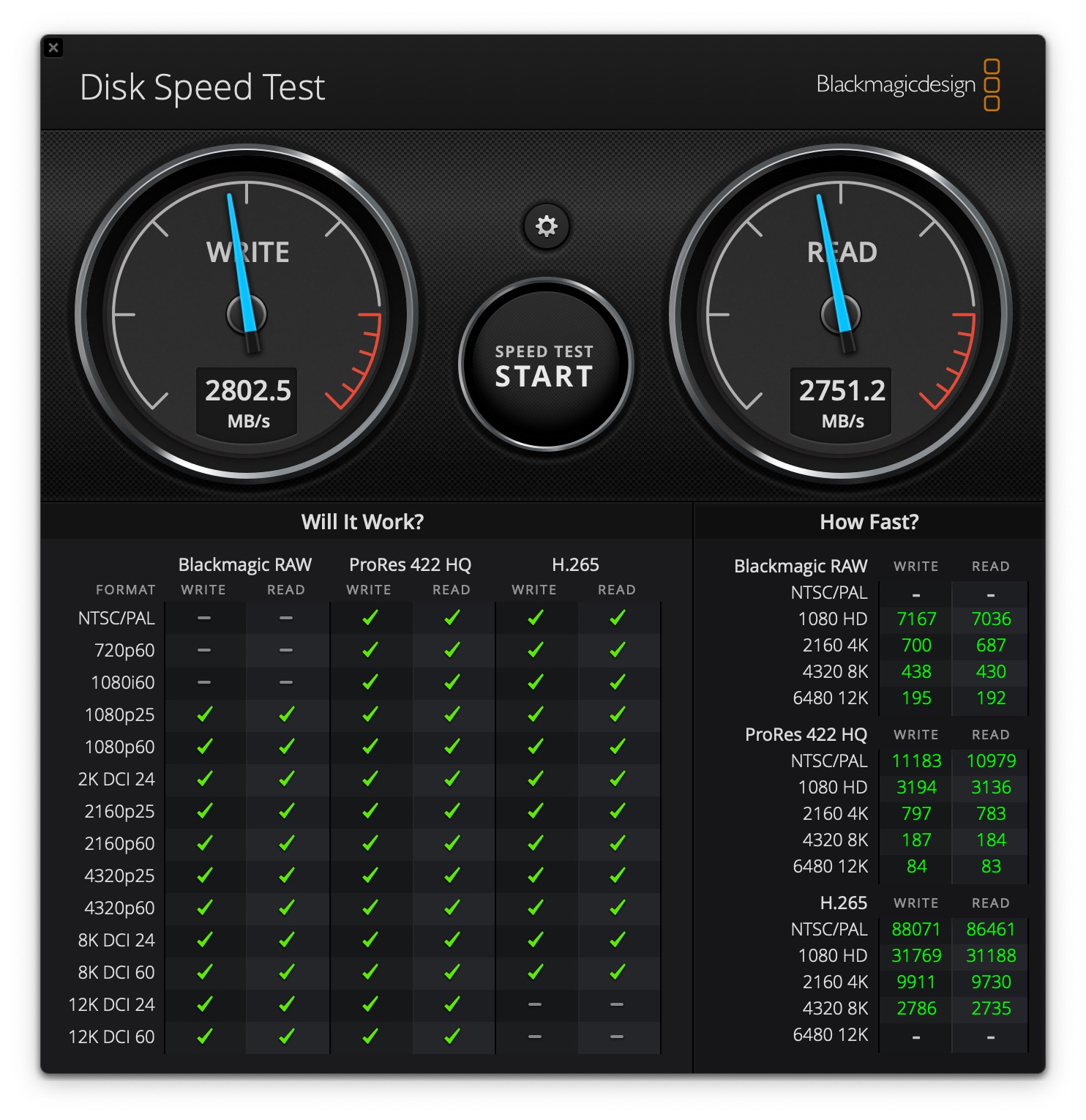

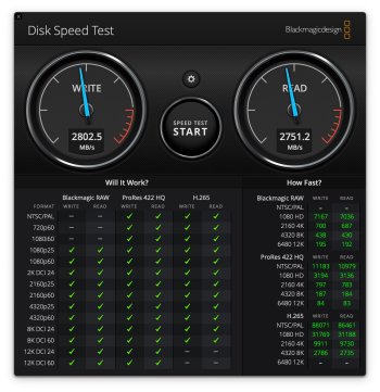

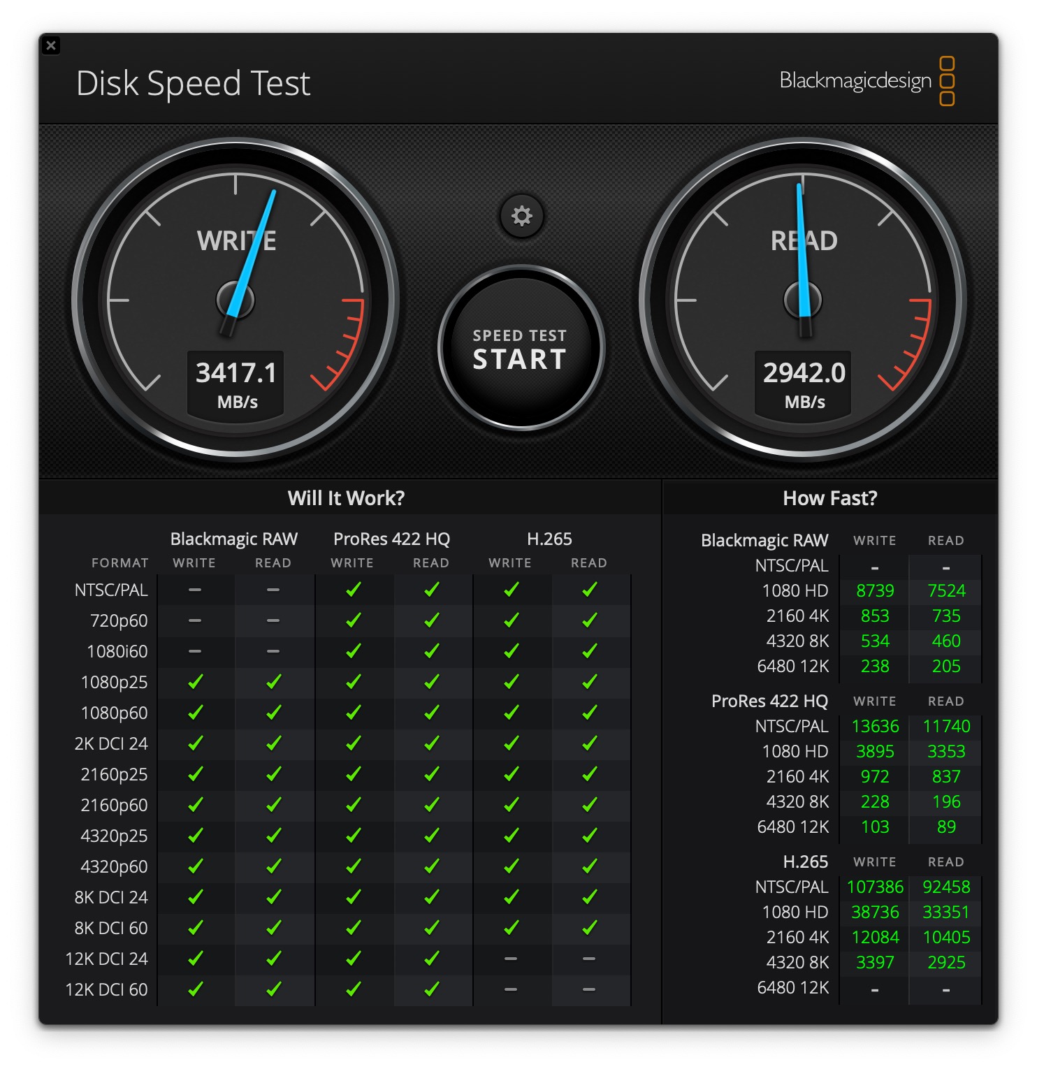

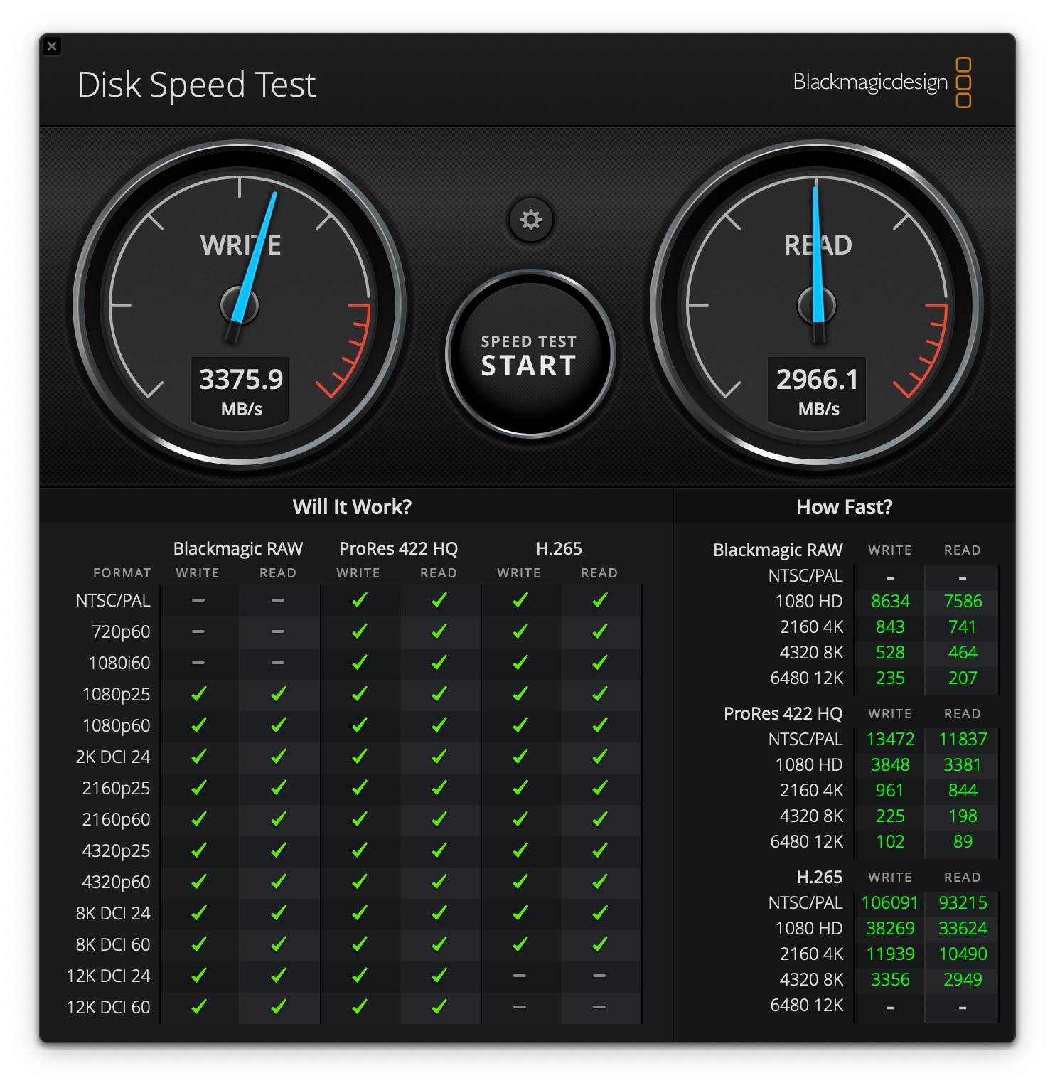

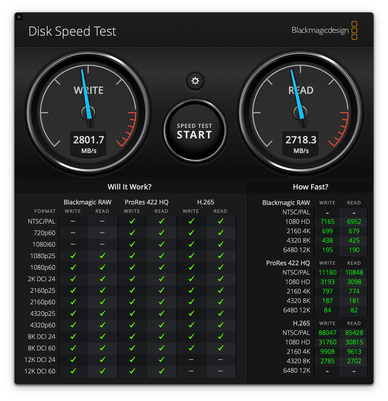

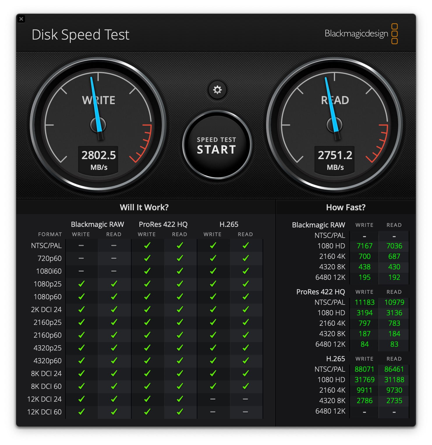

All has been said but I'd thought I throw in my external drive experience for my mini M2. I think Apple's internal is way to expensive and there are good options all around. I got a ACASIS 40Gbps M.2 NVMe SSD Enclosure (TBU401E) with a Samsung 980 PRO 2T and it runs lightning fast.
I'd be curious to see the metrics for the OEM SSD as well for comparison if you have time.
btw, the speeds I get with the Acasis/Samsung 980 Pro are absolutely not needed for basic storage requirements unless you intend to do heavy video or extremely large file transfers so often that the time saved is really important. If you make something that does half the speeds it will already be super fast.
Is the speed test being run on your external Acasis enclosure with the samsung 980 pro ssd?
In my post from April 13th up there the tests are from my Acasis (TBU401E) 40Gbps M.2 NVMe SSD Enclosure with a Samsung 980 Pro 2TB ssd. It tests in Blackmagic: steady at W:2800+ MB/s, R:2700+/- MB/s

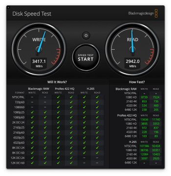

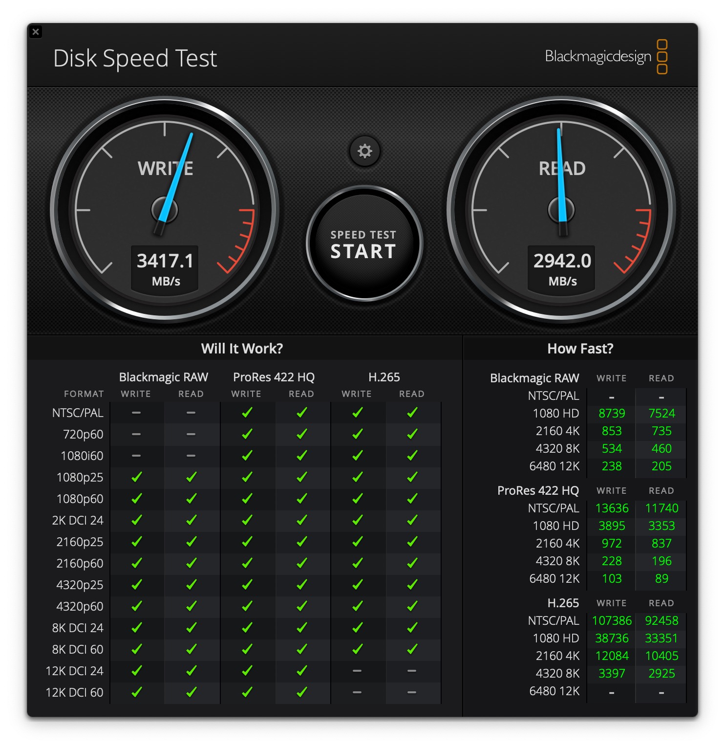

The tests shown in my post from yesterday is testing the speed from the internal apple ssd which tests in Blackmagic: steady at W:3400+ MB/s, R:3000+/- MB/s.
