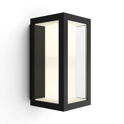

Something like this, for example. It’s not on the US online store but it’s similar to a cheap Amazon version I have now that looks good on my porch.
