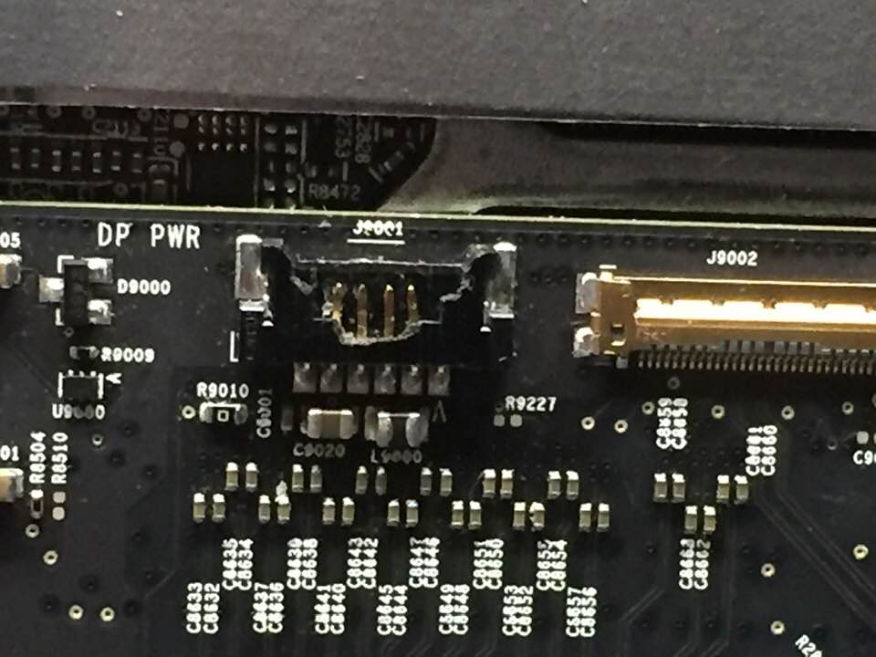

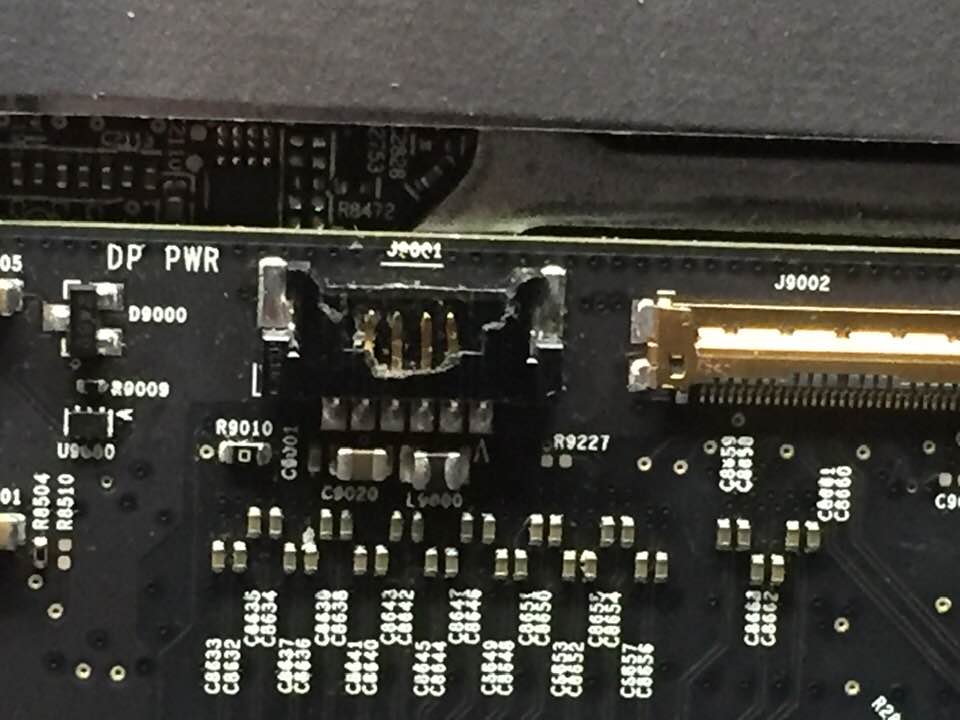

So, looks like it was a unplugged cable to the SSD! Now I'm on to another problem! I mangled the pins on the display power cable port! Any idea where I can get a new one to solder in? This is why I work on cars not computers!!! HAM HANDS!!! 🙂
Here is a picture of my "handy work"
Thank you all again, you've been a tremendous help!
