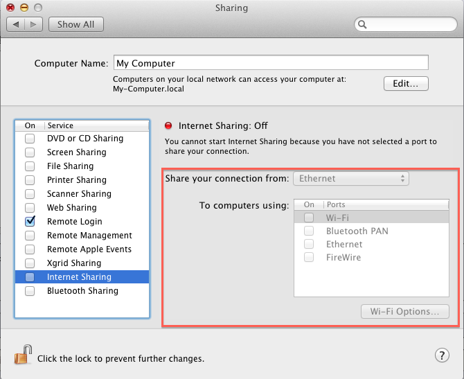

I'm trying to start internet sharing on my MacBookPro (13-inch, Mid 2012).
I'm running Mac OS X Lion 10.7.4 (11E2617).
Ethernet is on and connected. Wifi is on and connected to a created network (which I created to share out my internet).
Why are the options to turn it on greyed out? Any suggestions appreciated, as I'm tearing my hair out here.

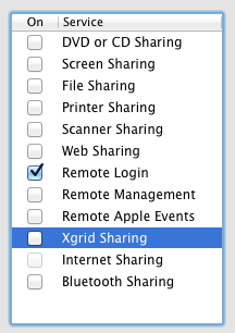

I cannot. The box is greyed out. (a non greyed out box appears as fully white when selected in the list.)

The control to select Wifi on the right is greyed out, as per the screenshot.
I want to check that box, but cannot.
Does anyone know where these settings are read from?
Maybe I can edit one of those files and trick the system into thinking that internet sharing is already on. Or set the wifi so that the port is selected.

Had to fix Network Preferences First
I had Network Preferences set to Automatic, which let me connect to internet through automatically detected WiFi. But in Sharing Preferences, Internet Sharing was unchecked, grayed out / greyed out, and there were no options under WiFi which was also grayed out / greyed out.
When I changed Network Preferences to Wifi, and it showed Wifi and Ethernet both unconnected. After Wifi connected and got an IP address, I was able to go to Sharing Preferences and place a checkmark next to Internet Sharing, and also Ethernet was available under Wifi and checked.
Hope this helps someone.
