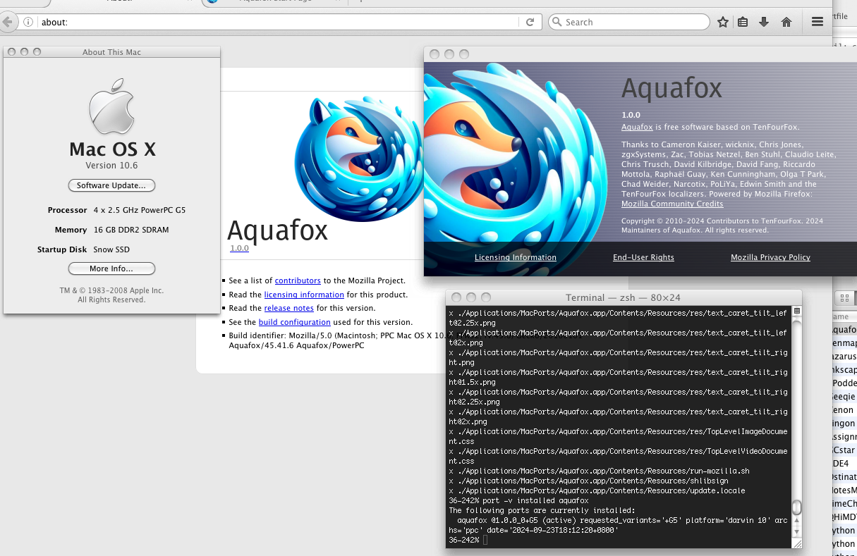

This was on a Power Mac G5 with a fresh MacPorts installation. The command `sudo port -v install tenfourfox-devel` will build for G4 by default, and it was the command issued that resulted in the build failure.

After my misfortunes with MacPorts on 10.5 and 10.4 on one of my Power Macs, I performed a fresh install of 10.5 and MacPorts on another machine, but the troubles continue. The dependency libgcc6 fails to compile. I am following the instructions, but perhaps I missed a memo somewhere because it’s not working for me.

I have no issues configuring aquafox, when I just replace existing portfile with yours (but keeping files dir):
Code:
36-242% sudo port -v -n configure aquafox +G5
Warning: configured user/group macports does not exist, will build as root
Portfile for aquafox changed since last build; discarding previous state.
--->  Computing dependencies for aquafox.
--->  Fetching distfiles for aquafox
--->  Aquafox-0785667d630acf269af554f538c19da181e5253f.tar.gz does not exist in /opt/local/var/macports/distfiles/tenfourfox
--->  Attempting to fetch Aquafox-0785667d630acf269af554f538c19da181e5253f.tar.gz from https://codeload.github.com/BlackBirdLC/Aquafox/legacy.tar.gz/0785667d630acf269af554f538c19da181e5253f?dummy=
  % Total    % Received % Xferd  Average Speed   Time    Time     Time  Current
                                 Dload  Upload   Total   Spent    Left  Speed
100  310M    0  310M    0     0  8695k      0 --:--:--  0:00:36 --:--:-- 8775k
--->  Verifying checksums for aquafox
--->  Checksumming Aquafox-0785667d630acf269af554f538c19da181e5253f.tar.gz
--->  Extracting aquafox
--->  Extracting Aquafox-0785667d630acf269af554f538c19da181e5253f.tar.gz
Executing:  cd "/opt/local/var/macports/build/_opt_PPCSnowLeopardPorts_www_tenfourfox/aquafox/work" && /usr/bin/gzip -dc '/opt/local/var/macports/distfiles/tenfourfox/Aquafox-0785667d630acf269af554f538c19da181e5253f.tar.gz' | /usr/bin/gnutar --no-same-owner -xf -
--->  Applying patches to aquafox
--->  Applying patch-ots-stdlog-fix.diff
Executing:  cd "/opt/local/var/macports/build/_opt_PPCSnowLeopardPorts_www_tenfourfox/aquafox/work/Aquafox-0785667d630acf269af554f538c19da181e5253f" && /usr/bin/patch -t -N -p1 < '/opt/PPCSnowLeopardPorts/www/tenfourfox/files/patch-ots-stdlog-fix.diff'
patching file gfx/ots/src/silf.cc
patching file gfx/ots/src/sill.cc
--->  Patching .mozconfig: s|-j2|-j6|
--->  Patching .mozconfig: s|/opt/local|/opt/local|g
Warning: reinplace s|/opt/local|/opt/local|g didn't change anything in /opt/local/var/macports/build/_opt_PPCSnowLeopardPorts_www_tenfourfox/aquafox/work/Aquafox-0785667d630acf269af554f538c19da181e5253f/.mozconfig
--->  Patching Makefile.in: s|/opt/local|/opt/local|g
Warning: reinplace s|/opt/local|/opt/local|g didn't change anything in /opt/local/var/macports/build/_opt_PPCSnowLeopardPorts_www_tenfourfox/aquafox/work/Aquafox-0785667d630acf269af554f538c19da181e5253f/media/libvpx/Makefile.in
Warning: reinplace s|/opt/local|/opt/local|g didn't change anything in /opt/local/var/macports/build/_opt_PPCSnowLeopardPorts_www_tenfourfox/aquafox/work/Aquafox-0785667d630acf269af554f538c19da181e5253f/config/external/nss/Makefile.in
--->  Patching 104fx_copy.sh: s|/opt/local|/opt/local|g
Warning: reinplace s|/opt/local|/opt/local|g didn't change anything in /opt/local/var/macports/build/_opt_PPCSnowLeopardPorts_www_tenfourfox/aquafox/work/Aquafox-0785667d630acf269af554f538c19da181e5253f/104fx_copy.sh
--->  Patching OptimizedFor.h: s|Debugging|macOS 10.6 on G5|g
Warning: reinplace s|Debugging|macOS 10.6 on G5|g didn't change anything in /opt/local/var/macports/build/_opt_PPCSnowLeopardPorts_www_tenfourfox/aquafox/work/Aquafox-0785667d630acf269af554f538c19da181e5253f/netwerk/protocol/http/OptimizedFor.h
--->  Configuring aquafox
Executing:  cd "/opt/local/var/macports/build/_opt_PPCSnowLeopardPorts_www_tenfourfox/aquafox/work/Aquafox-0785667d630acf269af554f538c19da181e5253f" && autoconf213 --verbose
Autoconf version 2.13
Anyway, I have put the build to run on 10.6 now, let us see how it goes. Will update on it once it either succeeds or fails.
Worked fine with no issues. Looks like it works :)

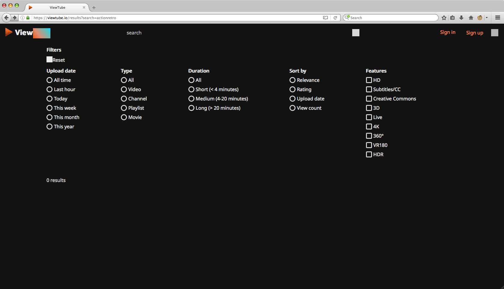

Greasemonkey 3.11 should work fine (for example, the file attached in the userscripts thread). What script do you use for ViewTube? The website seems to be broken.
