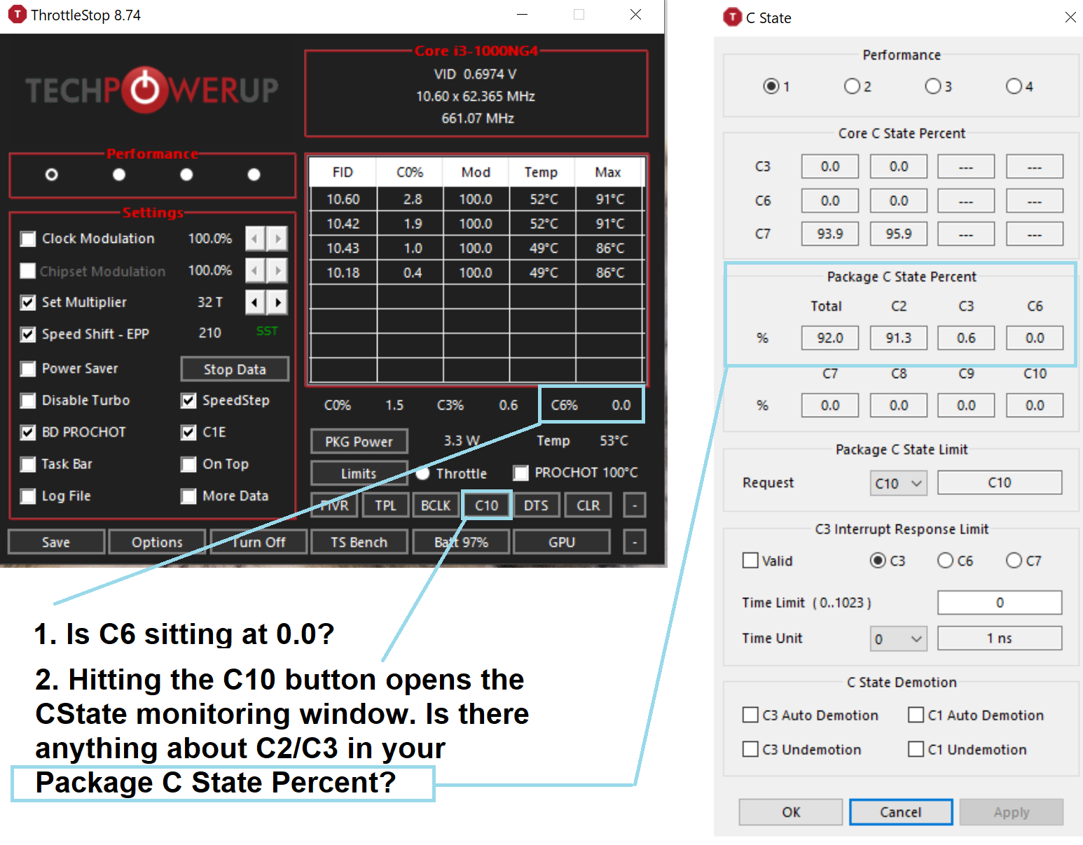

Would you (or anyone who is running Bootcamp) mind providing some data for my investigation?
Basically, I need to see if anyone is able to achieve processor deep sleep states (for Macbook Airs, the state is called C6) when running Windows.
The easiest way to do this is to run Throttlestop, which, although it's used for modifying clock speeds etc, we won't be doing.
What would really help is if people could the Visual Studio packages that underpin Throttlestop (they come with Windows Update anyway, these are just smaller files):
The two files you will need to install:
x64 file name: vcredist_x64.exe
x64 file direct download link from Microsoft: https://download.microsoft.com/download/2/E/6/2E61CFA4-993B-4DD4-91DA-3737CD5CD6E3/vcredist_x64.exe
x32 file name: vcredist_x86.exe
x32 file direct download link from Microsoft: https://download.microsoft.com/download/2/E/6/2E61CFA4-993B-4DD4-91DA-3737CD5CD6E3/vcredist_x86.exe
And then run Throttlestop 8.74 Beta, available from: https://www.techpowerup.com/download/techpowerup-throttlestop/
If you extract the files and run them, it won't install anything to your Mac, or change anything unless you turn it on. All we need to see is if there is any activity in the C6 package state.
So what we're looking for is in the below screenshot:
If anyone with a 2020 MBA running bootcamp is able to quickly post their results, and if somebody is able to access a C-state deeper than C2 and C3, that means it's at least possible. From there, once I've figured out how to replicate it, that's three-to-four hours of extra battery life on Windows (or potentially more, given the Ice Lake chip)!
Alrighty friends, looks like I'm going to have to admit defeat on this one for now. I've spent the last week digging around in every single driver for every single device that could be responsible for blocking lower C-states and killing the battery life in Windows, without success.
If any future user is able to access a C-state lower than C2/C3 in future, please post here, but at this stage it'll probably take a driver fix from Apple (and those are about as rare as Halley's comet on the Windows environment).
What's particularly frustrating about this is that the Ice Lake chip inside this notebook is capable of reaching C10. The 2015 Macbook Air I've been testing side by side on is able to get as low as C7, which means its package power draw, like the 2019 Macbook Air, is around 0.4w in Windows. Good enough for ten hours at 250 nits browsing/streaming/whatever.
Compare this with the 2020 i3, with its minimum draw of 2.2w despite all the tweaking/optimising I've attempted, or the 2020 i5 with a reported lowest idle wattage of 7w in Windows. Not great.
For whatever reason, the drivers for Macbook Air 9,2 (the 2020 series, including the i3, the i5 and the i7) just don't allow for the CPU to shift into 'chill out mode'. This not only impacts on battery life - you lose about four to five hours - but it impacts on the 2020's thermal issues.
By not letting the CPU do what it's designed to do and operate in a very low power state when there's not much being requested of it, it remains hotter for longer in Windows and - whilst providing good performance - will likely lower the chip's overall life cycle. Kinda like wearing out your transmission by highway driving in third gear.
