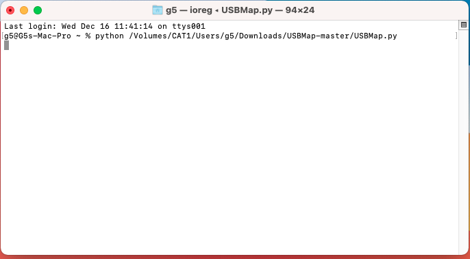

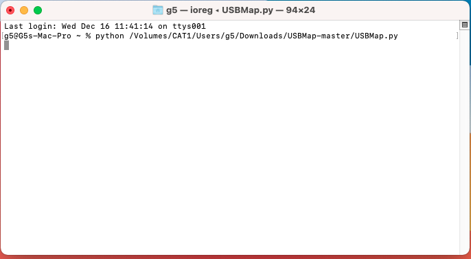

It seems to be related to USB as I tried:
Which also hangs.

Code:
Which also hangs.
Code:
system_profiler SPUSBDataType
USB:

Big Sur is relatively clean, and no USB patch via OpenCore, right?
startergo
macrumors 601
Sep 20, 2018
4,857
2,210
I found the issue guys. Some time ago my upgraded Bluetooth/WIFi module stopped recognizing the Bluetooth. Wifi was working fine. I just disconnected the connector with the 2 power leads from the logic board feeding the Bluetooth module. Now all those freezing applications started working as designed.
Edit:
And/Or the Bluetooth USB dongle. I plugged it back ON and those apps froze on start. Removed the dongle and they started. It is interesting that when the apps have started I can re-plug the USB dongle and they work fine (except IOregistryExplorer which hangs again). So some apps only hang on start when that USB Bluetooth dongle is plugged in.
Reactions: h9826790 and cdf
startergo
macrumors 601
Sep 20, 2018
4,857
2,210
I moved the USB dongle to my USB 3 hub and no more freezing. Apparently all this is related to the same USB issues in Big Sur.
