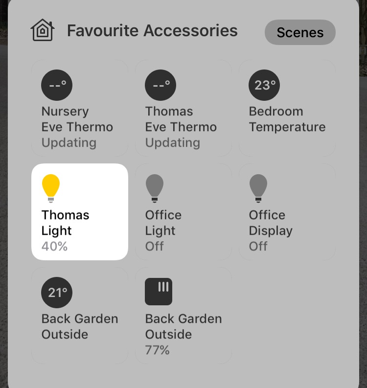

So I'm using the new Home app on iOS 10.
I have an Apple TV 3rd Gen, which acts as my home hub.
As well as some HomeBridge accessories, I am also running 2x Elgato Eve Thermo TRVs in my home.
Almost every time I open up the home app, or control center, my Eve Thermos just sit there "updating" for ages. (see attached screenshot)
Why, when I have a Home Hub, that should be regularly polling my devices, do I have to sit there and wait, staring at --, when my HomeHub should know what the temperature was at the last poll?
I should add that my Eve app displays the last known temperature, but it's so out of date, that it's probably just last time I opened the app.
Is there something wrong with my Eve's, with HomeKit itself, or with my setup?

The Apple TV 3rd generation isn't a true Home Hub - iOS 10 requires an Apple TV 4 to do that. The Apple TV 3 enables remote access, that's about it. Email me directly at adam (at) elgato (dot) com and I'm happy to help get to the bottom of this issue.
Turns out the issue was due to the devices having identical Siri Names. As they were both called "Eve Thermo." I noticed also that in the Eve app, the history was missing 9 days of data.
As soon as I renamed them in the Eve app, the data started to show up, and the devices updated faster on the Control centre.
The other thing I did was to set my AppleTV to always on... but that didn't seem to fix it (I never switched it back off)
It still Updates every time, but at least now it displays the old temperature on the dot.
