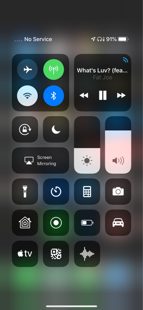

It’s still very slow at regaining signal between subway stops in NYC. Why would Apple even fix this if no one reports it? Exactly.
On T-Mobile.
In most cases it takes 5 mins to get a signal. For example while typing this I arrived at a Times Square stop, started walking to the 7 train and it took 4 minutes before I got signal. I mean come on.
Reported.
Curious what device. I do not do this often as I do not live or work in the city, but I recently was on the 1 train from Times Square station down to South Ferry and back again. I had service nearly the entire trip (even in the tunnel, not at a station). The times I did lose it, I regained within seconds of stopping at a station (didn't need to go to the street). Also on T-Mobile, iPhone XS. I was on 12.1.3 beta 2 at the time.

XS Max. Try the B, C train Frm Harlem to 42. It just takes long to regain signal between stations. It’s not all the time. Say the first two stops it regains fast then the next few it takes long enough that the train already got to the next two stops...
My issue was the 2/3 train transferring to the R/W where the same issue happened on verizon, but the last two betas it’s been 100% effective of a fix for restoring service upon station arrival.
I don’t know what changed. But I’m taking the same trip from Harlem to 59st, and already half through I’ve had signal come back instantly at each station. What the hell kinda of voodoo is this. Lmao.
It’s got a few inconsistencies here and there though. Like signal will come back as one bar and then go to no service. And remains a that way for 3 mins. But I’m happier now.
I'm sure you've probably already done so, but have you hard reset? what you experience happens to me on verizon once every couple days and it'll fix it. when I experience the issue, if i don't hard reset, i go without service for more than 10 minutes because the phone won't auto connect at all, and if/when it does, no LTE only 3G.
