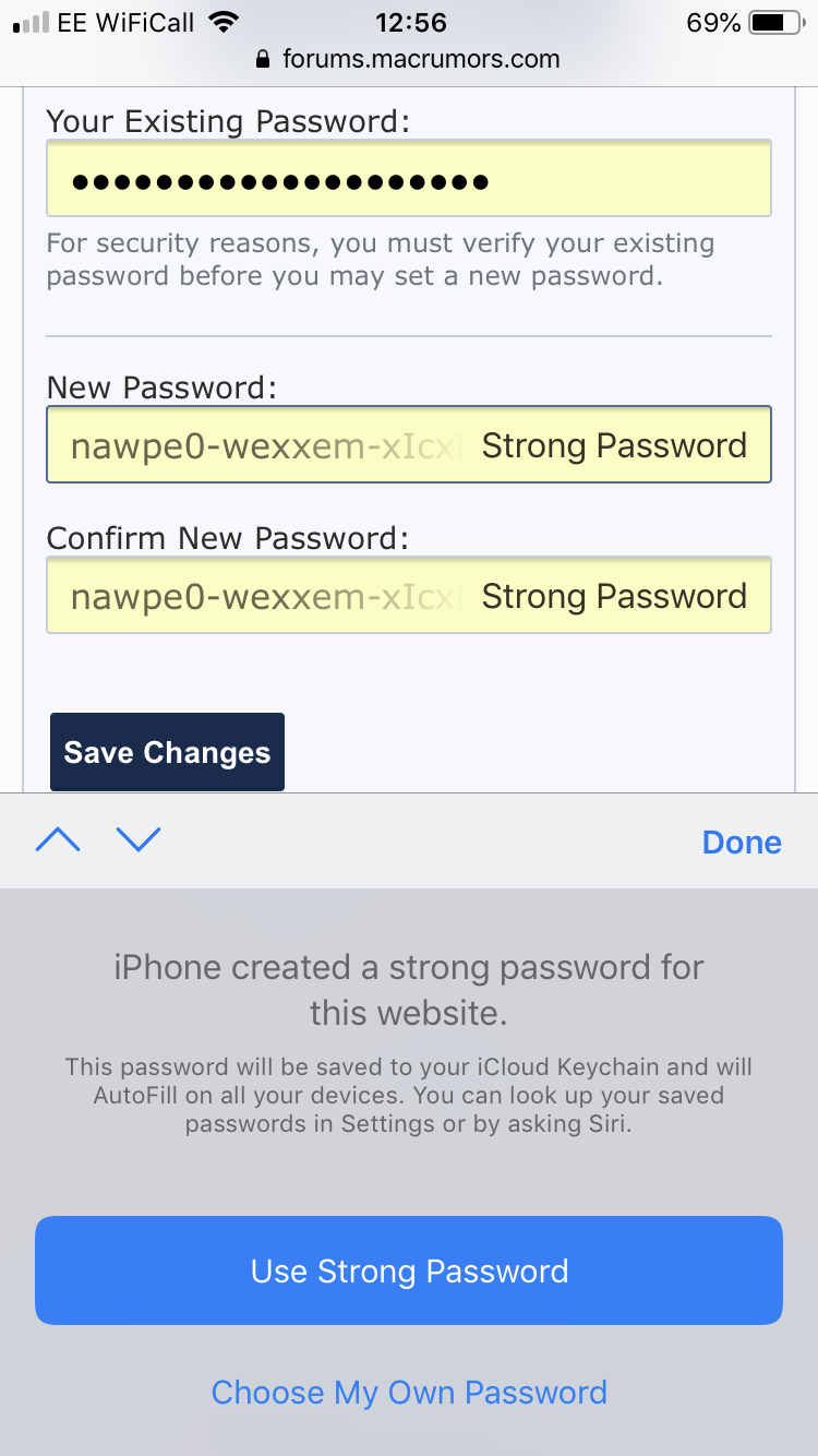

Yeah here’s it working on this very site, on the change password page.
I didn’t save the new password before you try to hack me 😉
I’m not sure what could be stopping it working on your devices... will have a think!

Yes. It’s failing to upload a pic at the mo but the new user registration form on this forum generates a strong password for me.
How many sites have you tried? Be aware that it’s partly down to the website correctly identifying the right fields as new password fields (either for updating passwords or creating new ones for new accounts). MacRumors forum is one where it’s definitely working for me, so I’d check if it works here to rule out poorly constructed websites being the cause.
