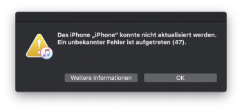

I then tried to use iTunes to update the phone manually, reinstall iOS 13.3 such that I keep my data, however the XS Max is stuck with 'unknown error occurred (47)'

Hate the be the bearer of bad news, but error 47 used to indicate a hardware failure in the baseband chipset.
If a DFU isn't working AND you've rebooted the computer you're connected to, AND you've tried different cables & ports then...
Do you have Apple Care or a warranty on the device?
You might also have to consider all the data lost on it as, even if Apple agree to deal with it, it's far more likely that they'll just swap it for a replacement. If it is the baseband hardware then they'll probably not attempt to fix it.
You may get better luck at an independent repair shop who are far more likely (for a price) pull the chip out and make a fix. However if you do find yourself going down this road then you should ascertain if such a fix will wipe any data.
Another option might be if the repair shop can at least get you to the where the phone boots in a harness to the point where you can at least download the pictures.

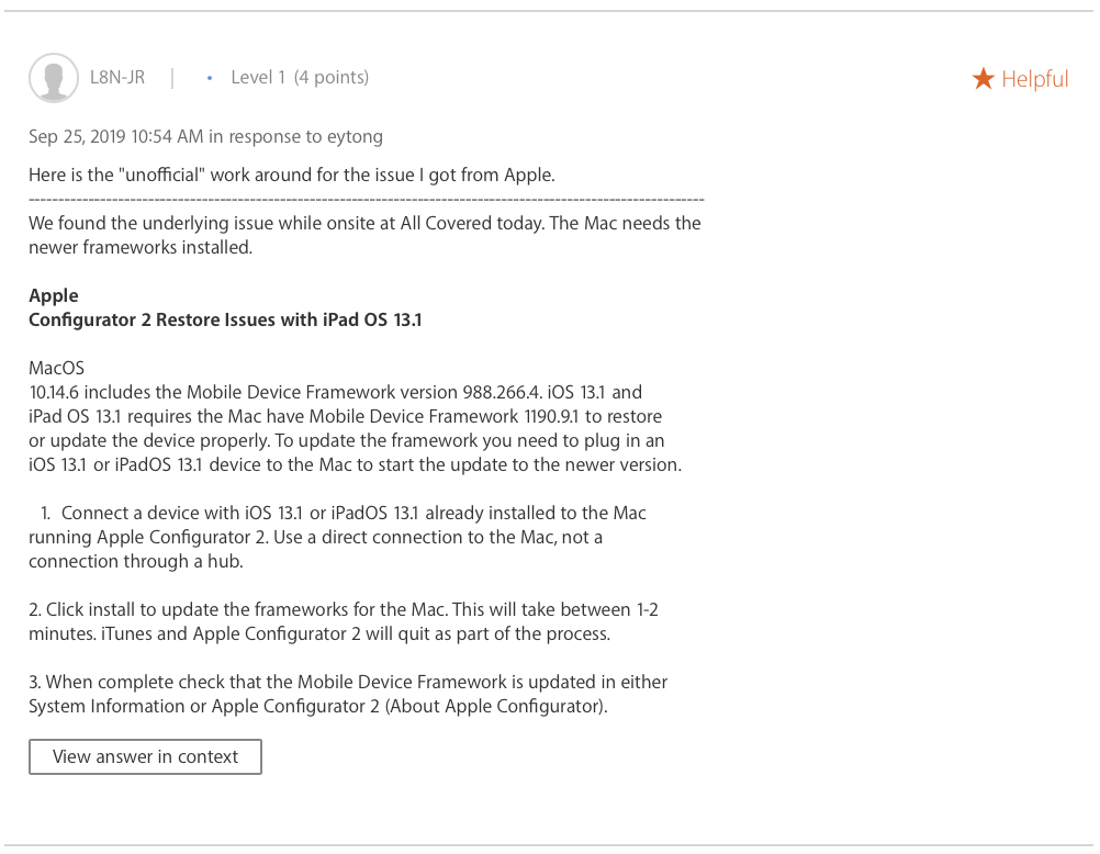

Meanwhile.. I found something useful on discussions.apple.com, which is somewhat of a highlight itself, cause (at least in my case) that has not ever happened before. 🥳
User L8N-JR
After following these steps, I got further than ever before.

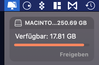

After AC2 unpacked iOS (step 3/4) & everything seemed promising. Then my MacBook told me that my storage was full.
Which is weird, I had about 17GB free storage when starting the repair operation in AC2 & the 5,3GB of iOS 13.3 were downloaded already.

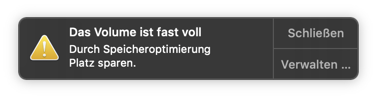

I was forced to reboot, given my Macbook told me it had only 62.4MB of available storage:
