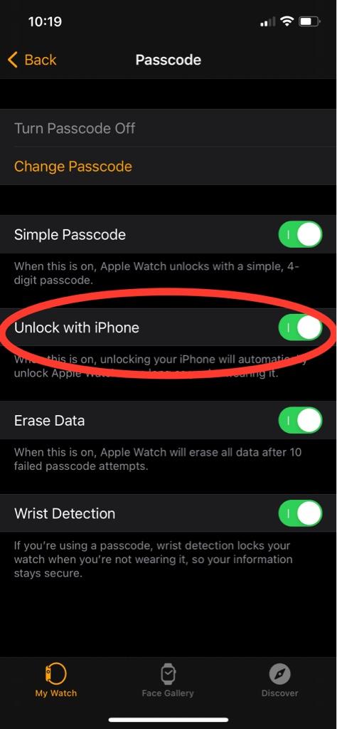

Can someone explain this? Is my phone supposed to be unlocking my watch? I only have to type the passcode in after I put it on my wrist…My watch has never been able to unlock my iPhone; I assumed that feature was reserved for faceID iPhones.
This feature has been there since watchOS 5 and supports both touchID and faceID phones. When you unlock your iPhone, it's suppose to unlock your Apple Watch as well. Been working fairly well for me until 14.7.
The setting for it is in the Apple Watch app.

Ok this morning again it would not unlock (the watch) with phone. Went into settings (one phone) and, Face ID & passcode, enters passcode, slid down to unlock with Apple Watch, turned off. Now one again took watch off wrist confirmed it was locked and phone locked. Put watch back on wrist, it was locked, opened phone and once again it worked.
