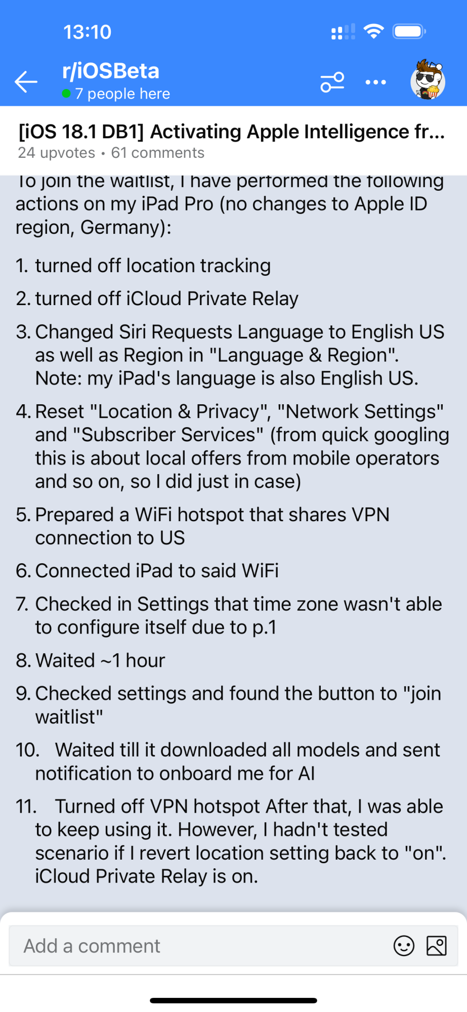

Set your region to US. Download the IPSW from Apple. Plug your iPad in and update from a computer to 18.1 again. Should work.
Read this on Reddit but haven’t tried it myself (yet)

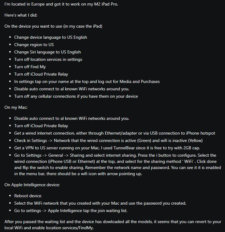

It worked and even not with all the steps. (I'm in the EU)
On M1 iPad Pro my steps were:
- As on 17.5 switched Language, Region and Siri to US English
- Turned off Location services
- Turned off iCloud Private Relay
- Turned of Find My
- Signed out from Media & Purchases
- Disabled auto-join on known and available networks (WiFi model, no cellular connections)
And after all the above I have updated to iPadOS 18.1 Beta from Settings -> General.
After the update I was able to join waiting list once I connected to the local WiFi network (no VPN) and a few minutes later the AI was available to turn on, working as of now. I've turned on all the settings back on but kept US English as language and region.
Tried all the same steps with iPhone 15 Pro Max (both with the iPad bought from and activated in the UK) and it did NOT work.
The only difference to the iPad are the cellular networks (which I've turned completely off) and the fact that I cannot turn off Find My as Advanced data protection is on and couldn't turn off (it gives an error it could not be switched off).
