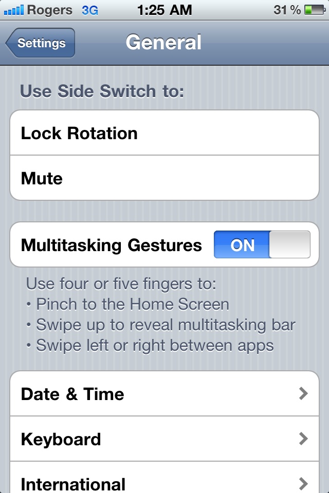

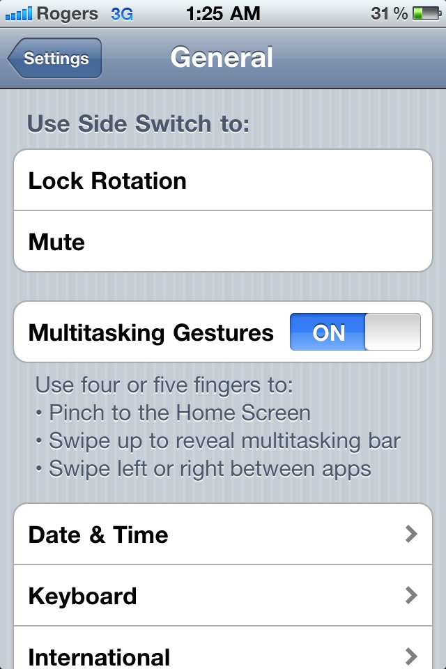

Multitasking gestures work for me on 4.3.2 just swimmingly. Complete with toggle under General settings as well as the explanation on how to use it. Looks like a proper feature/setting.
Mute/rotation lock edit for the silent switch also works.

Multitouch gestures work for me on 4.3.2 just swimmingly. Complete with toggle under General settings as well as the explanation on how to use it. Looks like a proper feature/setting.
VeySO3z
Could you please tell how did you do it? I tried everything but won't work. Thx.
I agree. Although I don't have the toggle in Settings.app, the gestures work better than ever. Better tha 4.3.1, actually. I think Apple is starting to support us jailbreakers xD
But yes, I would love to have a toggle just like you. Let me guess: you used Sn0wbreeze, and wanted to preserve your baseband?
If not, how?
Like I said before, any kind of plist edit that used to work in past versions will not work in iOS 4.3.2. Manual enabling of the toggle is broke in 4.3.2. If you had it enabled in 4.3.1, then you might still have a chance at enabling it.
Any post after this that says a plist edit did not enable the gestures will be marked as stupid.
UPDATED: Now featuring 110% more Multitasking Gesture toggle goodness! (In other words, I fixed my stupid mistake and properly added the code. Lousy iPhone.)

From a clean restore, I manually enabled the multitasking toggle, so I'm afraid I'm not sure what you're talking about.
Once you have multitasking actually enabled and you can use it, all you need to do to get the toggle like I have it is to copy and paste this text (without quotes) into /Applications/Preferences.app/General.plist

That also includes the rotation lock/mute toggle.
You're going to have to paste this into the correct spot for it to work proper. Your phone will have the entries regarding rotation/mute lock that you see above. So match those up, highlight it and paste over the old ones and you'll be good to go. Respring and it should be working.

You won't believe it. The entries you put above were there BUT for some STRANGE reason, there were two "mutltitasking" (notice the wrong spelling?) entries instead "multitasking" I corrected those and now it is working. Don't ask me why the spelling was wrong. I never touched that plist before. The rotation/mute is not there but I am sure it is something stupid like this which prevents it from working 🙂
Thanks again!
If you just edited your regular General.plist file without copying/pasting what I had, the mute/rotate shouldn't work.
Find the lines that look similar to these, again, yours will be different if you didn't copy/paste.

Once you find those entries, you may notice the last lines in each "dict" or section, whatever you want to call it, looks something like this:
Code:
<key>requiredCapabilities</key>
<array>
   <string>ipad</string>
</array
Which tells it, "Hey, this toggle only works if you're an iPad." By removing those lines from the above section(s), the mute/rotation lock should work. I hope that helps!

      <string>PSSwitchCell</string>
      <key>default</key>
      <true/>
      <key>defaults</key>
      <string>com.apple.springboard</string>
      <key>key</key>
      <string>SBUseSystemGestures</string>
      <key>label</key>
      <string>Multitasking Gestures</string>
      <array>
        <string>multitasking-gestures</string>
      </array>
    </dict>
    <dict>
      <key>cell</key>
      <string>PSGroupCell</string>
    </dict>
Please forgive me if that doesn't make sense, I'm half asleep and typing this on my diePhone, which is a bit of a pain. If you have questions, please ask before you do anything so you don't bork your phone and get mad and yell-y at me. 🙂
P.S. I did not use SnowBreeze and I do not preserve my basebands or use any sort of unlock. I use iFile to edit plists using the text viewer method.
P.P.S Both of those sites quoted above simply show how to enable gestures, they don't show how to enable the toggle in Settings.app
I did this since iOS 4.3b1. Exact same lines. iOS 4.3.2 is the first one for this mod to not work.
No, I think you misunderstood what I just said. First, I called no one stupid yet because no one said anything about the plist edit after that post. Second, even if they asked, they would be filling this thread with useless posts, like this one, when their answer is in the first post. Please don't make me write any more stupid posts.
Obviously you understood what I meant.
The only thing I can suggest is double checking for errors and where you placed it, or just copy/paste what I've got there. Cause it's working for me and at least one other as of now.
