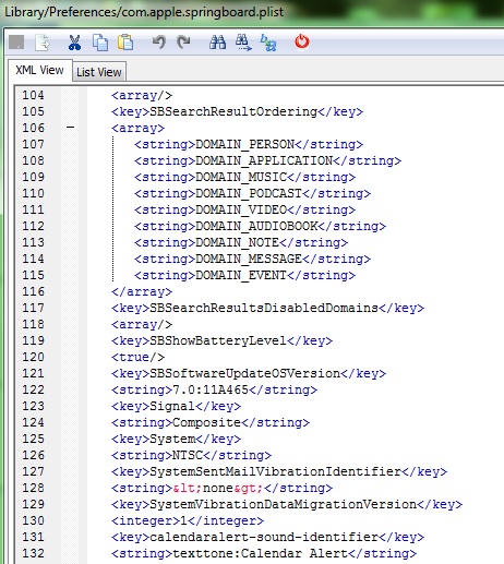

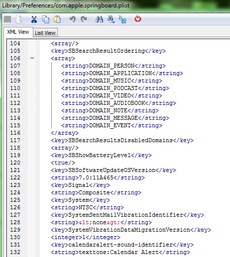

Attached is a small section of the backup file. The code about the battery percentage is at lines 119 and 120. Like others have mentioned though, the percentage display number jumps around a lot and doesn't seem to be real accurate. But it's there. Hope this helps.
I will report back when I do it. Thanks for the help!

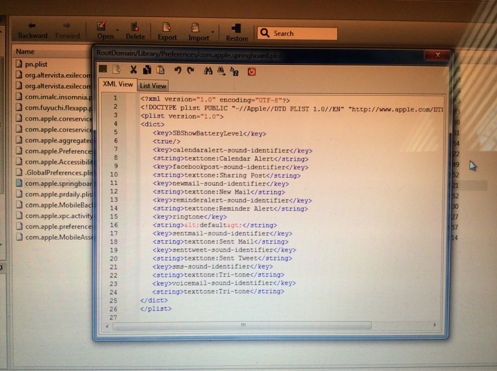

I don't have 120 lines:
If you reread my first post I mentioned that in my ibackupbot file there are 2 entries for the file "Library/Preferences/com.apple.springboard.plist". One of them is very small, like the one you posted. The other one has many, many more lines of code and that is the one I updated with the battery percent stuff. Look through your entire ibackupbot file for a second entry with that same name and put the code in that one. Good Luck.
I got the percentage now. I though I was to add the code myself. I notice the code was already in the file and I just had to make it true from false. I got the percent now!
