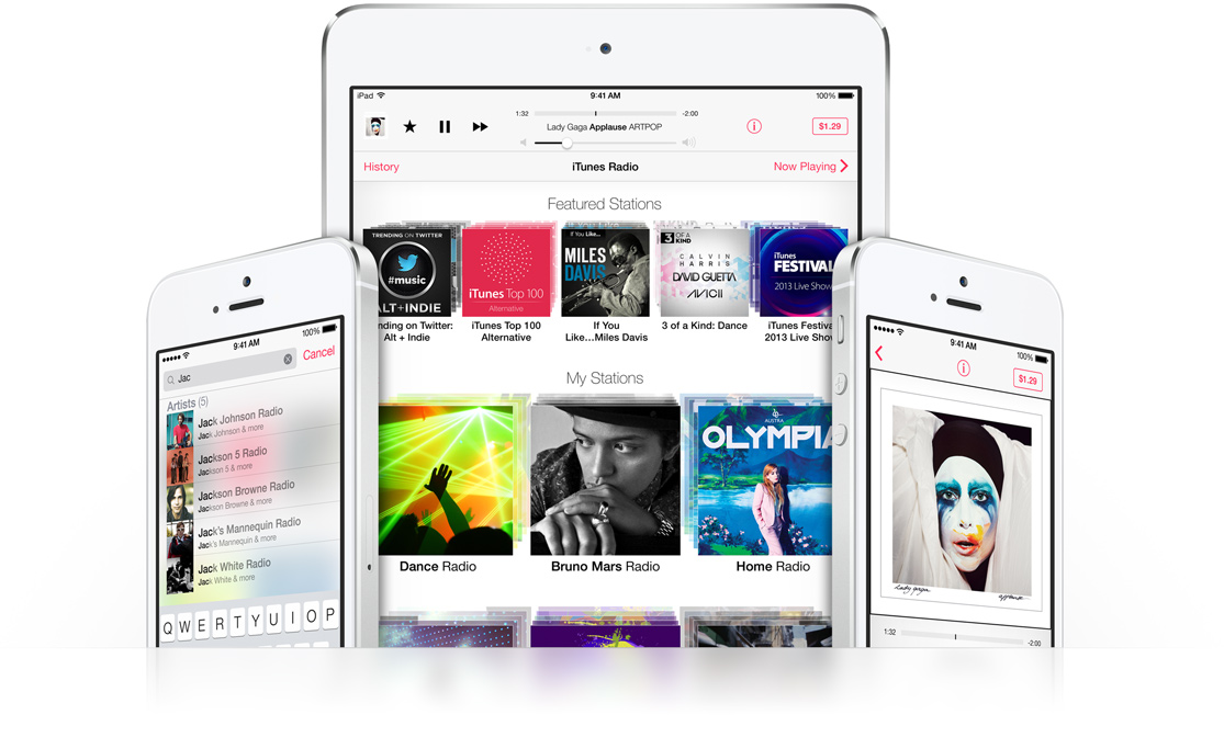

Is it possible to create a button in iOS 7 with a border the way that Apple did in iTunes Radio? (See attached screenshot and notice the "$1.29" button in the top right of the UI).
I have tried the following, but it does not work..
self.replayButton.layer.borderWidth=1.0f;
self.replayButton.layer.borderColor = [[UIColor blackColor] CGColor];
Any ideas/suggestions?

Sure it's possible, but I would advise against it. Apple is moving away from buttons with rounded rectangle borders. Any place you use them is going to look out of place in an iOS 7 app, and you will start to get dinged for it.
As for why iTunes Radio still has a rounded button, I suspect 1 of 2 things: It's a vestige that they haven't updated yet, or there is a holdout for the old look in the iTunes team. If there is a holdout on the iTunes Radio team that likes the old style, they will likely get smacked around and forced to update to follow the new UI Guidelines.
All that being said, what you want to do is quite easy and you are on the right track.
You need to create a custom subclass of UIButton, and set your button(s) to use that class. Then set your button type to "custom" in IB.
Finally, add setup code in your custom button class that does this:
Code:
  self.layer.borderWidth = 1;
  self.layer.borderColor = [UIColor lightGrayColor].CGColor;
  self.layer.cornerRadius = 8;
  self.layer.masksToBounds = YES;
The last line, setting masksToBounds to YES, isn't strictly necessary unless you are going to fill the button with a color (which you will probably want to do).

Thanks, I'll give that a shot...
I know that Apple is moving away from those buttons, but there is a very specific use case I am looking to use this for. All of the other buttons in my app are the standard borderless buttons.
In this case, I have a table cell with some labels in it and then a button on the right side of the cell. The problem is, no one realizes it is a button so they don't attempt to press it. Just adding the border will help a lot I think. If not, I may have to use an icon maybe....

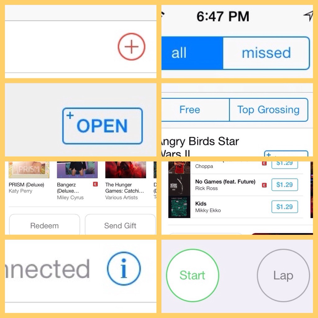

Yes. Even though Apple features bordered, rounded corner buttons it in at least 8 of their redesigned apps, Apple is "moving away" and you will look out of place if you make your app match Apple's iOS7 style.
It's true that Apple isn't entirely consistent.
However, what they changed is their rounded rectangle style buttons. Two of your examples are (new style) segmented controls, and three are special-purpose circular buttons. I only count 3 actual examples of rounded rectangle buttons in your post.
