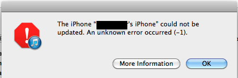

So this morning I connected to my computer with the USB cable that came with my phone and accepted the prompts to update. Agree to terms and conditions, transfer items, etc etc. Then I had progress bars in iTunes for "Backing up," "Waiting for iPhone," "Verifying update with Apple," "Waiting for iPhone" again. The Apple logo appeared (in iOS 7 style without the shine) with an empty progress bar on my phone.
During the second "Waiting for iPhone" progress bar, I got an error on the computer (see attached) saying the following: "The iPhone '[My iPhone]' could not be updated. An unknown error occurred (-1)." My two options were "More Information," which took me here: http://support.apple.com/kb/TS3694 and "OK" which stopped the process on iTunes only. The knowledge base article just said to try restoring two more times (no, I wasn't trying to restore, but that is the link I got from the error message). So everything in iTunes stopped. But the phone stayed on with the iOS 7 Apple logo and the empty progress bar. I waited a few minutes. Touched the screen. Held down the power button. Pressed the home button. Nothing happened. The phone just sat there with the Apple logo and empty progress bar.
