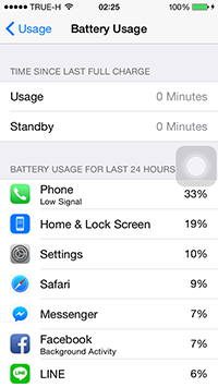

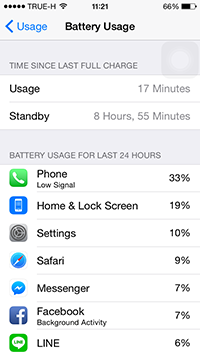

I have found a problem with my iPhone 5s. It seem to be drain faster than iOS 7 era.
Even standby, after it full charge on night. i unplugged it and go to sleep.
After that i wake up, and found my battery has only 66%. as you clearly seen on picture 1-4.
What i have try :
1 I have full restore, setup as new phone, full restore in dfu mode, full restore with other mac etc. <- no change.
2 I disable all feature such as background app refresh, location service, push mail. <- no change
3 After seen "Phone Low Signal". I try to put my iPhone in airplane mode, but the drainage hasn't stop.
Please help me fix this problem.
First night : Full charge at 2:54
8 hour later, after i wake up. please notice it show "Phone Low Signal" but in my situation my iPhone got full of signal (RSSI~77);

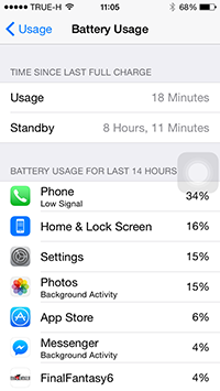

Second Night :
What i have try :

Have you always had a low signal for the phone? That appears to be draining your battery. Are you placing it in an area where the signal is weakest? Try a different placement.
He's got a -77dBm signal which is very strong. The signal shouldn't be the problem regardless of what the usage screen says.
