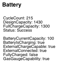

can you take it into an Apple Store for battery diagnosis? alternatively some apps like ibackupbot and coconut battery can tell you cycle count and capacity. just to rule out battery issues?

I've attached an image from ibackupbot to this reply.
The cycle count is high, but I would expect that most of those cycles are coming from the last few months, since battery life is not making it past a couple of hours of actual usage anymore.
An interesting detail that I've noticed the last few days, is that when the remaining life percentage is low, I can plug it in, and as soon as the phone makes the connected to power sound, the charge remaining level will jump up 20%.
This kind of lends to my thoughts that it is a software issue, that iOS is incorrectly reporting actual battery life remaining.
While the full charge capacity is 130 less than factory numbers, I still don't see that it would be low enough to be losing 10% in 5 minutes of light use (such as typing). Especially when I'm used to being able to type and text for at least a half hour before seeing the percentage drop a bit from 100%.
The sudden decrease in battery life, has only been an issue since updating to 8.3. It was a sudden nose dive.
The interesting discrepancies between charge level when unplugged and immediately upon being plugged in, is also curious.
Another interesting thing I noticed, and this may just be how ibackupbot reports it, is that the phone was 100% charged at the time, it had been plugged in an left at 100% charge for at least an hour prior to taking this screenshot (and obviously was still plugged in when taking this screenshot). So, it's interesting that it says it is not fully charged in the report. Maybe that's just how the program reports it. I don't know.
The jumps in battery percentages are often a sign of something going on with the battery itself, despite it seemingly being unlikely based on most other things. Have you tried recalibrating the battery meter (by draining the battery until the phone shuts off and then recharging it all the way to the top)?
