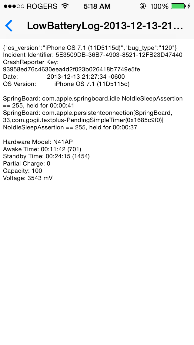

one time in the winter i fully charged the battery 100% before i left, by the time i got to my bus stop 15 mins later, with the phone in my sleeve + hand around it so its moderately slightly warm, it shut down & gave me low battery icon, took about 20 tries then it booted, & said 100%...was beyond pissed. i still have the lowbatterylog from that as well, the apple genius was speechless when i showed him it & 10 mins later said it failed 100% of diags
look at those awake/standby times
partial charge shows i did a full charge
the capacity it "died" at
