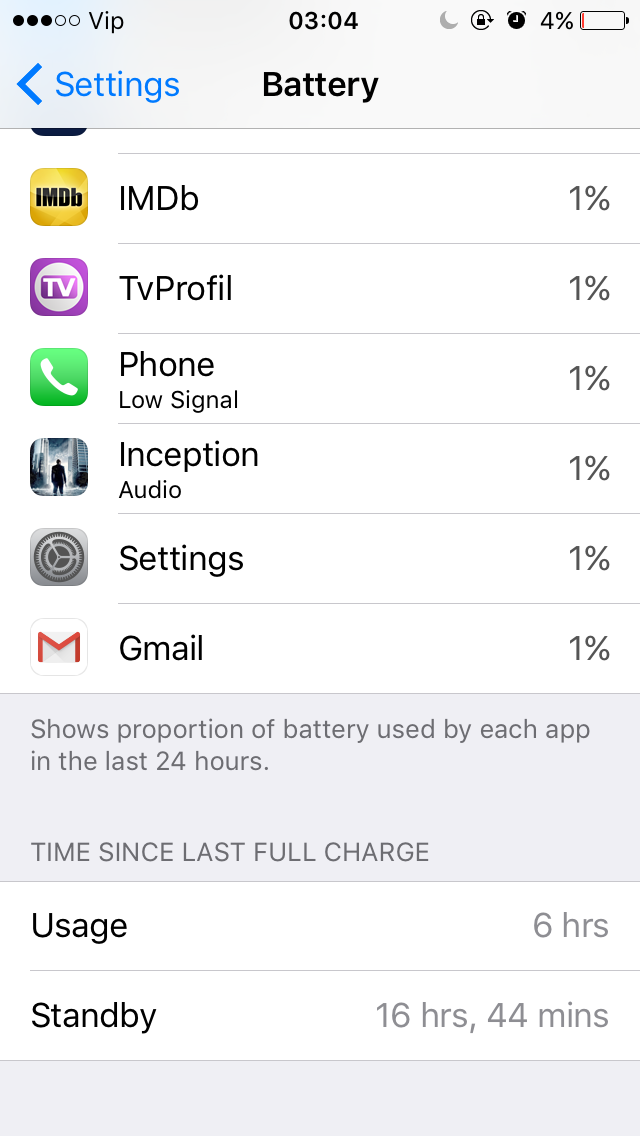

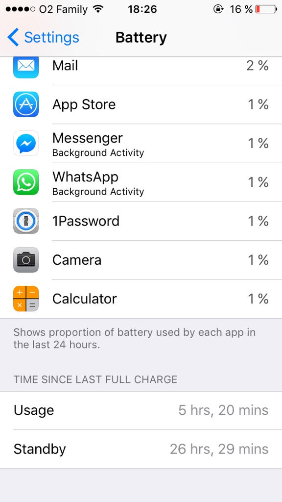

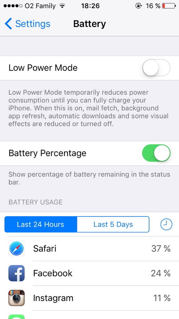

My iPhone 5S battery. 9.3 fresh install, I didnt use low power mode at all. Its 2 years old
Resetting settings and restoring phones could potentially eliminate many hidden issues affecting battery life. Don't even need to mention that there are always new features to potentially affect battery life. Heck, iPhone 5s is already 2 years old. I don't expect my iPhone 4 could last 4 hrs under iOS 7 because it is over 4 years old.
But of course, you can just sit here, ranting. Everyone sometimes just do this. I can understand.
