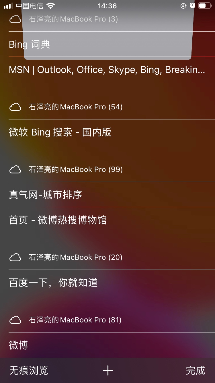

I have the same problem. My system version is the same as yours.
Every time I open Safari and then open tabs on my mac, it looks like a new device on my iPhone's safari.
In addition, I found that every time I log in to iCloud through Safari, I will be required to fill in two-factor authentication, although I already trust the browser. I tried Edge and Chrome on my Mac, and completely reinstalled my macOS, even upgrade to Big Sur, but nothing changed. Each login requires two-factor authentication. Maybe that why you have two iCloud tabs, because a reopened safari will be considered as a new device.
I have no idea how to fix it, maybe it's a bug.

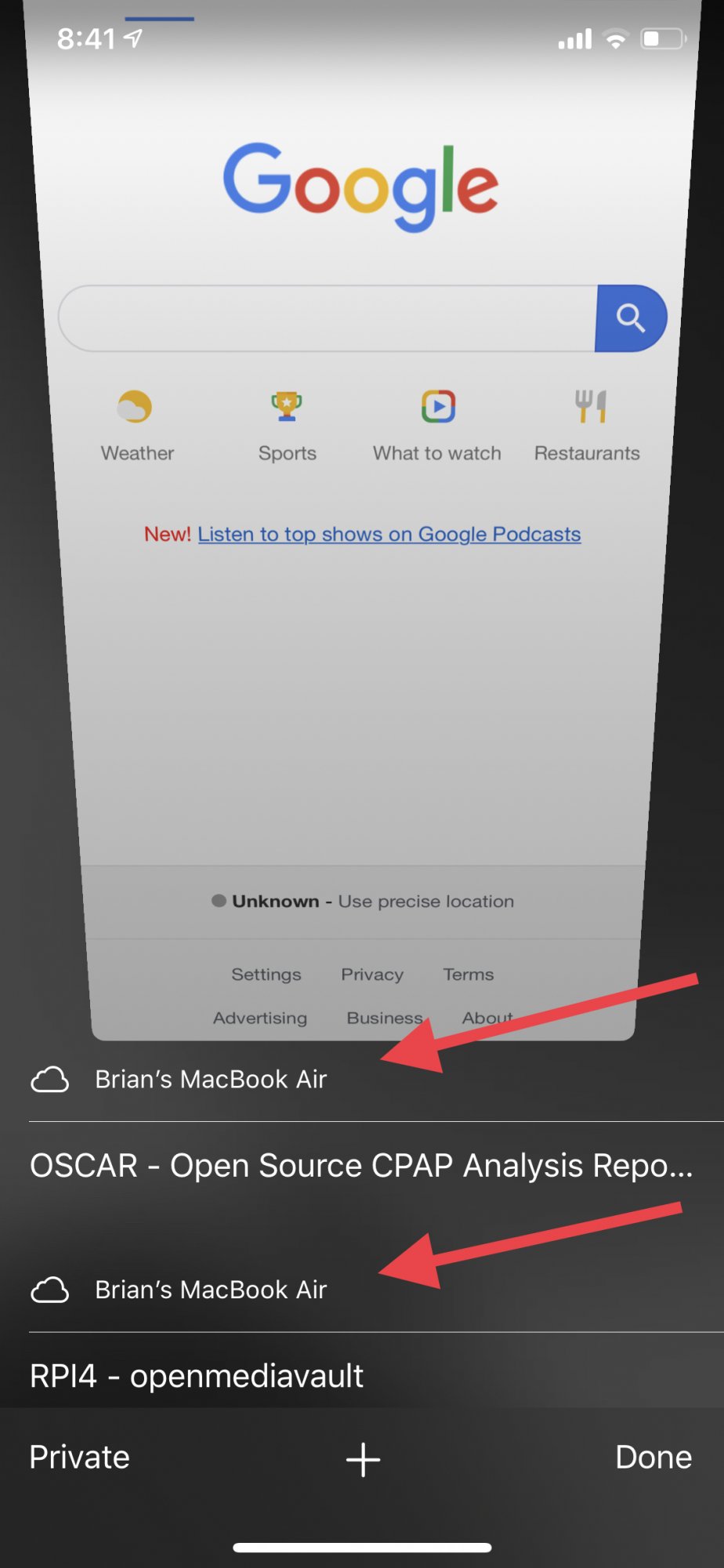

I have similar issue with my MBA. Have anyone found solution for this bug?
