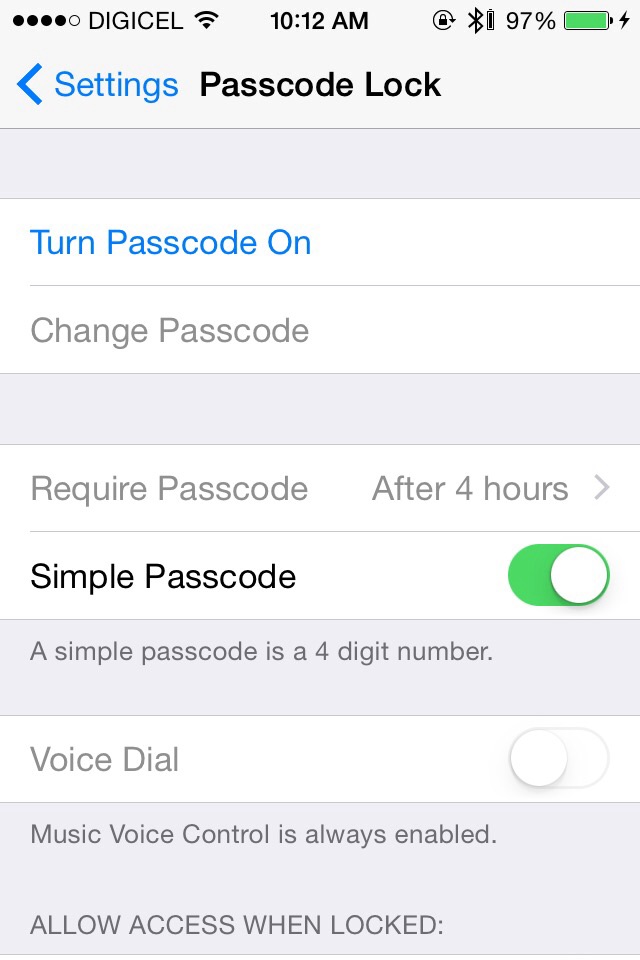

iOS 8 does not require a password.
I just turned off mine.
Maybe you're using a company phone or something that's preventing you from disabling the password.

Sorry I mis read what you said. I don't have iOS 8 on my iPad so I can't confirm. But disabling it on the iPhone and I got no prompt.
