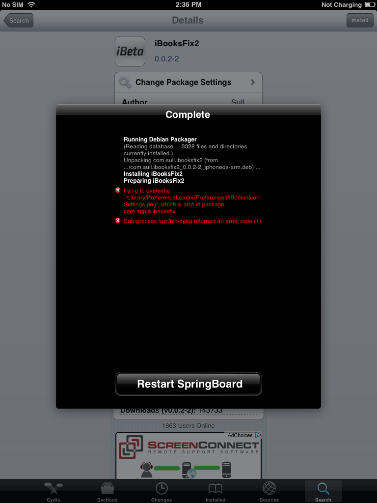

iBooks will not open on ios 5.0.1 jailbroken iPad 1
I have ran the latest redsn0w 0.9.10b3. Tried logging in using ifunbox on Windows & copying the iBookFixGizmoWebs.deb. Tried manually removing using ifunbox and re-installing, not opening until running iBooksFix2 and get this error
So based on that image, your iBooks folder is messed up, and you can't delete it? First time I've heard of iBookFixGizmoWeb.deb don't know what it does. Do you have iFile?
What I would do, if I didn't want to restore again, would be to try deleting in /var/mobile/Applications/ the old iBooks folder, (if you have iFile install, and set it to Applications Name on in preferences this folder will be the folder with a random name)
Then in /var/stash/Applications you'll want to delete the iBooks folder. Then uninstall iBooksFix2. Then reboot your iPad. That should clear iBooks off the home screen and permit you to download it again. Once you've reinstalled iBooks install the iBooksFix2 again, and when prompted respring your iPad. After that completes reboot your iPad and then try opening it.
Wish you luck. The hardest part without iFile is finding the correct folder name. As all application folders are given random names.

I do have iFile, and can navigate to var/mobile/Applications, but in there are all sorts of folders with random letters and numbers
. I am using windows and also have iFunbox which allows me to get in here also. What I did earlier which I think may have messed me up is deleted in the Applications folder the iBooks folder. Then tried re-installing, and installing the IBooksFix2, but this is when I ran into this problem.
If you have purchased iFile, and perhaps even if you haven't if you tap on that little gear icon, you'll get iFile's preference screen, about half way down is an option to turn on Application names. Switch it on and you'll see the *real* (maybe human understandable names is a better choice than real) folder names. Be careful when using windows it can change permissions on you, and that will prevent programs from running...

That was very helpful, so now I see where iBooks is. Once in there I click on it and show the folders inside Documents, iBooks.app, Library, tmp, as well as two files. From this point what do I need to do in order to delete this folder?
Ok, so figured that out. Clicked edit, slected iBooks, and clicked on the trash symbol, now going to try the rest.
You go back to the folder where you see the iBooks folder that was a random name before. You tap on edit, check it (that random name folder before). Then delete it. Note that will also delet all books and PDF files that you have in iBooks. So be sure you have backup copies of them. iTunes should allow you to redownload the one you bought from there. The more difficult ones will be the PDF files, and other books in your iBooks that you obtain else where.
You could use funbox to copy the folders to your PC, just in case before you delete them. Hopefully everything important to you is in iTunes on your PC.
It worked! You are a genious thanks again!
