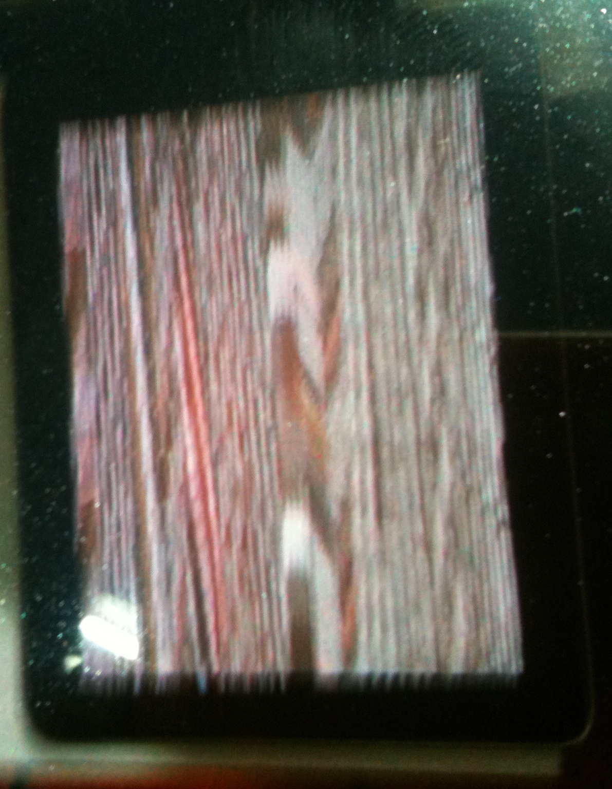

Attached is how the screen look like before it went into the current state.
Hope this picture helps.
That looks to me like hardware failure. You can try taking it to Apple and see what they will do for you for an out of warranty replacement, but it's probably time to move on.

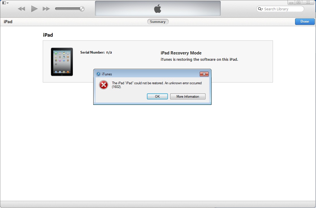

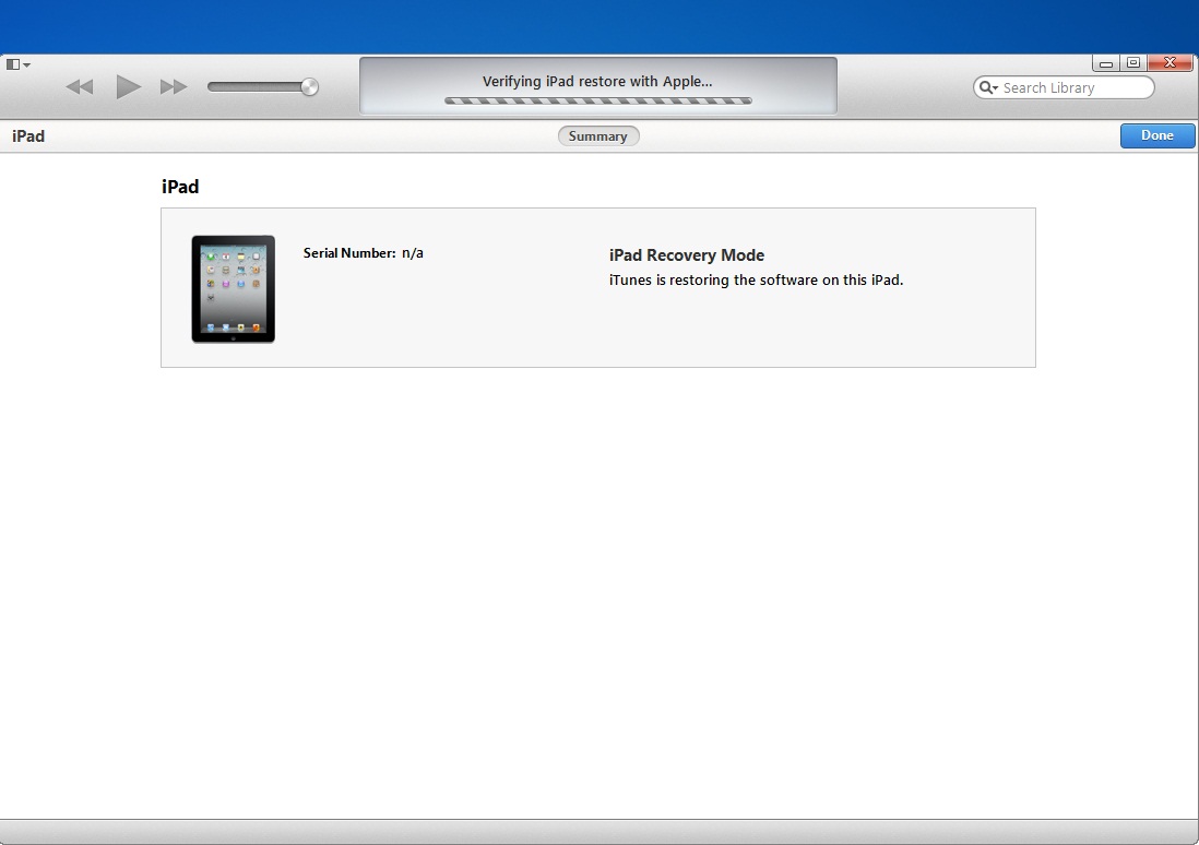

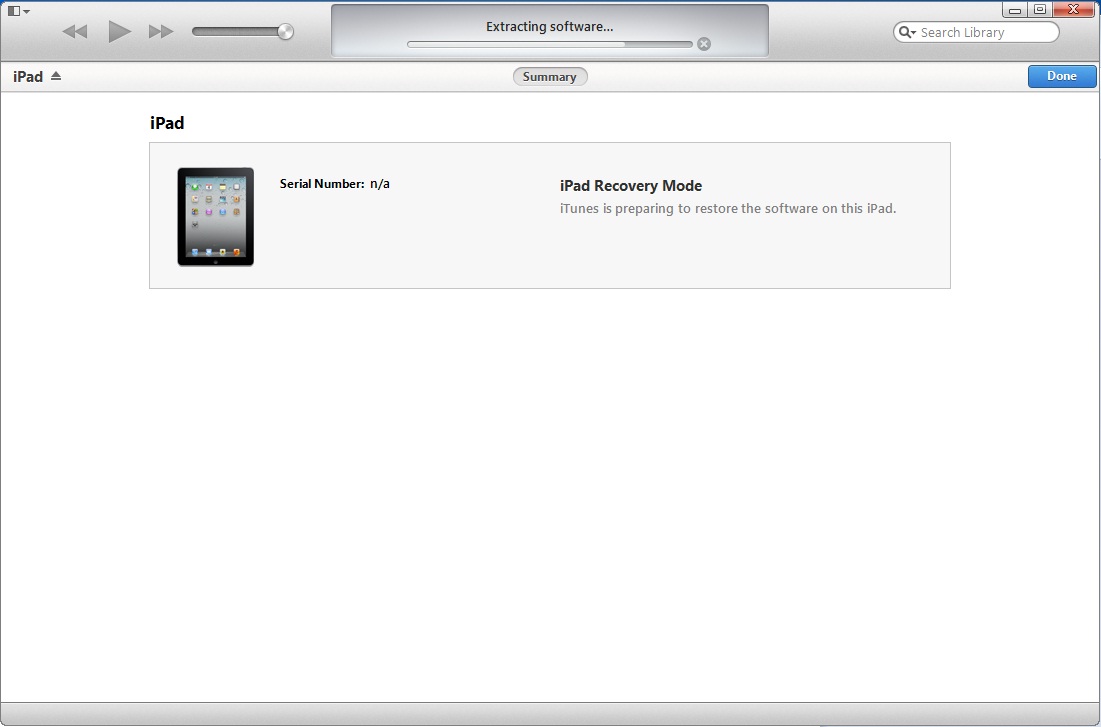

Now the iPad is with me.
These are the things I saw when doing the recovering.
Base on the DFU and the recover mode.
I suspect it is mostly likely the buttom problem.
Because I dont have to press any key to this mode.
So it does start up, despite what you said before.
It's very likely either crap software or a blown display or graphics chip. You could try the DFU but if that doesn't work it's trash. Sure you could go to apple for an OOW swap but that's like $250 at least and its a better use of money to toss in another $50 and get a first get mini than an OOW iPad 1
