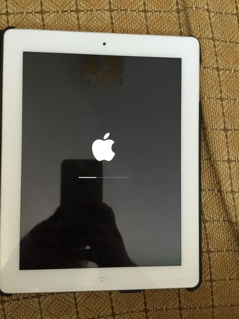

My iPad2 16GB wifi was running iOS7.1.2 before I upgraded it to iOS 9 last night,this morning I only get into once after answered those normal questions when upgrading the iOS,I found it is running a little bit lag,so I decided to reboot the device,somehow it keeps crashing rebooting and I'm no longer able to get into the system,I don't want to lose data but how can I resolve this issue?
I tried to connect it to a PC which has iTunes installed,I could not see the device because it stuck at the white apple screen with a progress bar,bar is increasing but device would reboot after the bar reaches about 30% of its length,then repeat the same.

I'd put it in DFU mode and restore it through iTunes to iOS 9. All your stuff will be erased, though. But you can restore from a backup on iOS 9.

Not making a back up before any software update is a huge mistake. The other was going from iOS 7 to iOS 9 without iOS 8. There's currently a bug in iOS 9 on older devices the causes this exact problem when going from 7 to 9. Try this: http://9to5mac.com/2015/09/18/how-to-fix-slide-to-upgrade-error-ios-9/. If that doesn't work the only option to get the iPad working again is to do a DFU restore using iTunes, and set the device up as a new, not restoring back up. You will lose the data if you did not make an iTunes backup. This issue is being caused by restores from iCloud.

Even if there is an iCloud back up it can not be restored when this issue occurs. Trying will put the device in a boot loop. It has to be restored from an iTunes backup, or set up as new.
Chat with apple tech,no way to recovery the data,give up,will do DFU.

Looks like apple fix this issue with iOS9.0.1 updates,I connected my iPad 2 to PC,put it in DFU mode,iTunes will give the option to update("update" button showed up beside "Restore" button),hit the "update" button,then my iPad upgraded to latest version and my data are there.
Good thing that I did not follow apple tech support's suggestion to erase all the data.
