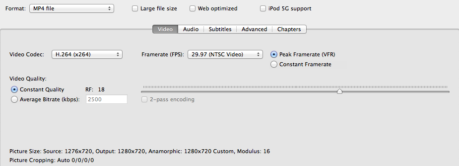

    Could you please elaborate, explain in detail? When you say "CQ" do you mean the Constant Quality Slider? If so, why 18? Is it because the lower the number the better, same quality of source?

    Yes, the CQ slider is that. The lower the number, the better the quality. Careful, file sizes can get big quick!

    So basically this (pic), right? Well besides it being 720 rather 1080…

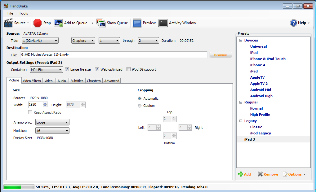

    Where, in Handbrake, do you set the output resolution? I can see what my input picture res is, but not where to modify what my output is (horizontal and vertical).

    Mine's greyed out

    Using the Apple TV 2 Preset as my base, on the video tab I adjusted the width to 1920. It appear greyed out but is not, just use the arrows. See screen shot below.
    My file size is 7GB (Rango) - 11GB (Avatar) for 1080p. This is 3x the Apple TV 2 preset in Handbrake. A far cry more than Engadget's reports minimal increase in size for iTunes 1080p.
    I'm testing settings in an Apple TV 3 thread that say to check Web Optimization and add the following string to the Advanced box:
    vbv-bufsize=31250:vbv-maxrate=25000
