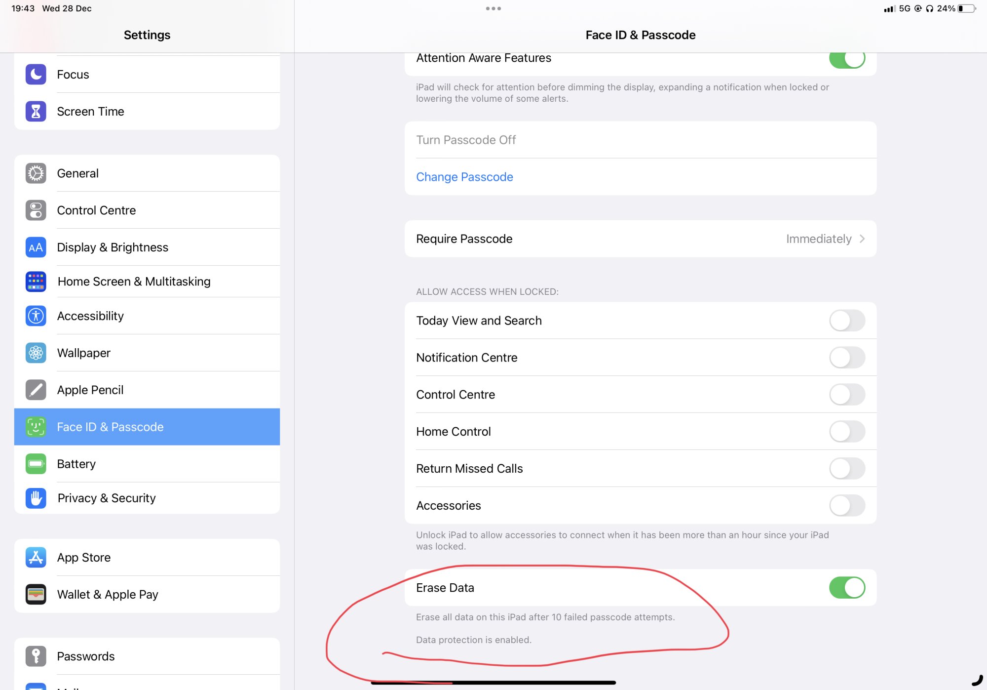

I see on the Passcode-Lock screen, you can make it erase itself after 10 failed attempts.
Isn't that what I want?
If it erases itself this way ... is the iDevice in the same state as if someone had been able to successfully manually execute a "Settings > General > Reset > Erase All Content and Settings" procedure ?
After each wrong attempt, you'll be asked to wait longer and longer before you get the chance to try again. It could take days.

2. After each wrong attempt, you'll be asked to wait longer and longer before you get the chance to try again. It could take days.
1. Cool. So, it won't mess-up any of my real iCloud stuff and real iDevices on my Mac-Mini? I don't want this DFU project to change or sync with my real-stuff in any way.
2. It's a special option at the very bottom of Passcode Options. I'm already up to 6 attempts and it's not making we wait for anything.

2. Interesting, maybe it’s got a version of iPadOS that doesn’t have rate limiting yet? You can keep going and if the iPad doesn’t wipe, you can still DFU it later.

2. I think so. I guess I'll just turn-on that option ... try to hack-in a few more times. When it gets to 10, it should just erase itself. Since "Find My" is already OFF, sounds like it will be completely erased (like a new one, OoB ... no locks or tied/associated to anything or anybody).
Well, (best I can tell) it's not the normal Passcode stopping me (because it's currently off/un-assigned).
It's the "Restrictions Passcode" that I need before I can Erase it. Why they put Parental Restrictions on my Mother-In-Law's iPad ... I have no idea. And no, it's the common ones that start with 1 or anything else I thought to try.

Something note about erase attempt, it is 10 for at least iOS 7, and never change to any other number, and it is still 10 on the latest iOS/iPadOS.
