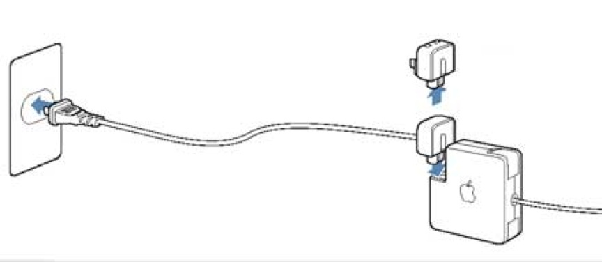

Change from using the "Duckhead" connector on the iPad's Charger to the 6 Foot long Cable that plugs into the charger. That will ground your iPad. (Electricity has this thing called grounding- look it up)

How exactly, is a 2 prong connector going to establish earth ground?
Anyhow - it's not grounding related - it's leakage current from the switching supply in the charger itself.
