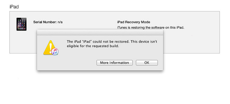

Yes, I put it to DFU, and tried again.
The iTunes extracts downloaded software for a while, and then it pops up an error message.
And it shows following link for more info. I have tried to modify the hostfiles in UNIX part, and there is no line for "GS.APPLE.COM"in my host file, so it doesnt apply according to the support page.
https://support.apple.com/en-gb/HT201442
I do not use any security software in my MAC PRO, and no firewalls. So I am wondering if my MacPro OS being 10.7.5 might be causing the update/restore failure?
The last update iTunes for 10.7.5 was in August 2015. I'd wager it doesn't support iOS 11. Mavericks is the oldest version of macOS that will run a version of iTunes that support iOS 11.
Yes, or just update to the latest macis you can. Is 10.7 the latest yours will run?
Yes, my Mac is a very old MacPro 1.1 from 2006-2007, so I think OSx 10.7.5 is the latest it can run. But strange that it runs latest iTunes 12.2.25? Not sure if it is the latest iTunes, but when checked for update, it says that it is already the latest version iTunes.
My friend has a PC laptop with Windows 10, and Mac with OSx 10.8 or 10.9, so maybe iTunes in these machines could bring back this iPad 4 into life from locked state at present?
That version of iTunes is the last update apple allowed for 10.7 and it won’t support the mini 4 or iOS 11. If you’ve got a friend close by that will let you use their computer do that. You can also just install windows 7 (or 10 even) on a separate partition on your Mac Pro and use that.
it says that if you have the latest version the system can run. And the actual current version is 12.7. I believe iOS 11 needs 12.5.
so yes if your friend has a Mac or a PC that can run that version you can try to restore the iPad with that.
