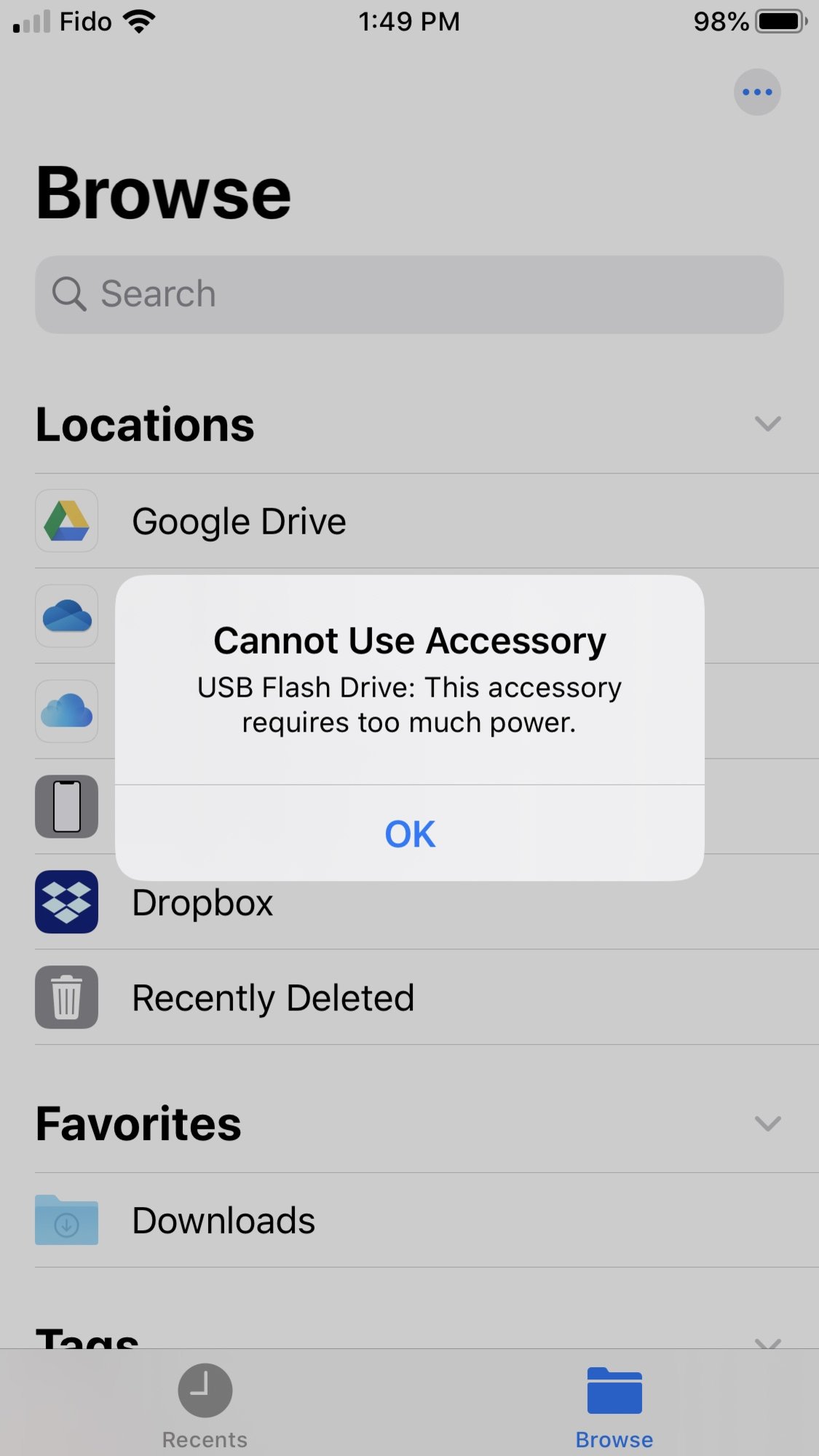

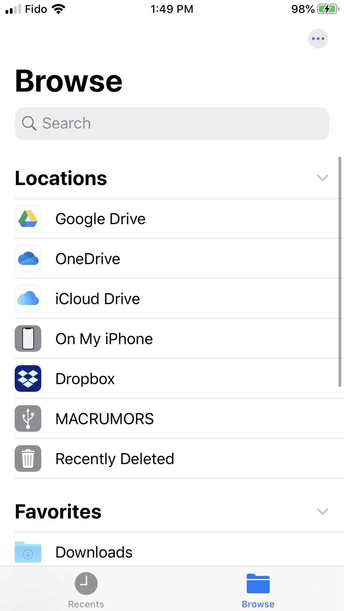

So I just tried this with my Lightning to USB 3 Camera Adapter on my iPhone 7 Plus, with 3 different USB flash drives (2 Lexar and 1 Imation) and they all worked.
With no external power:
With Lightning power:
Note the MACRUMORS USB drive connected. This was formatted as FAT32.
I even tried a Samsung T5 SSD formatted as APFS and that worked too. Interestingly, I didn't get the insufficient power message for the T5 when the Lightning power cable was disconnected. The drive was simply invisible, presumably because the power was insufficient for the drive to provide any info at all so the phone couldn't recognize it at all. However, once I plugged in Lightning power, it got recognized as a USB drive just fine.
So that's 4 different USB drives that worked with the Lightning to USB 3 Camera Adapter, but only once I plugged in external power. None of the 4 worked without external power.

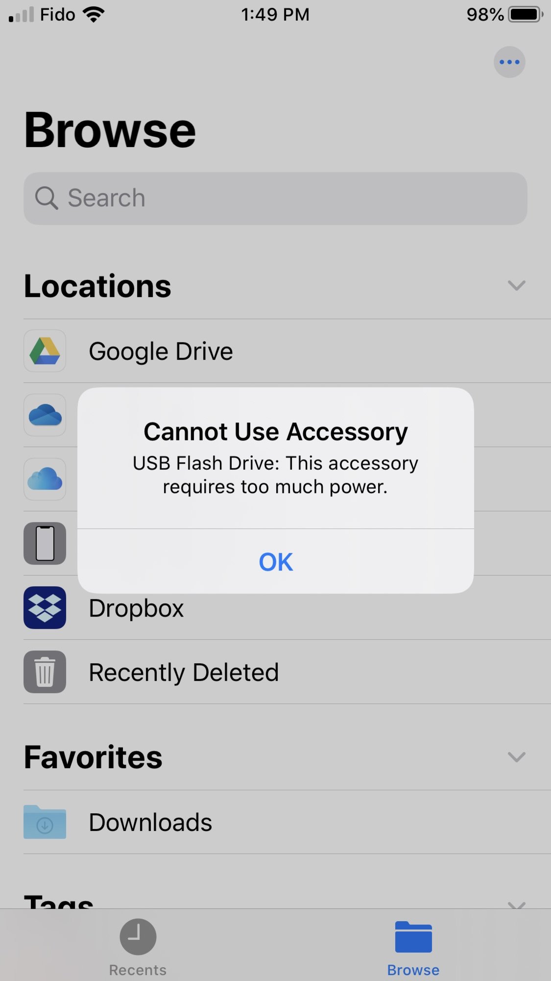

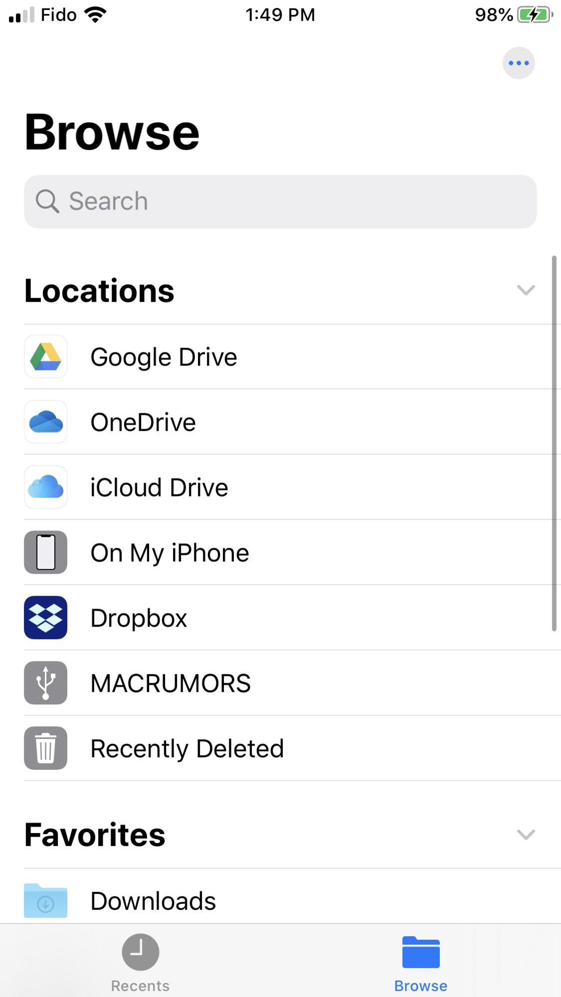

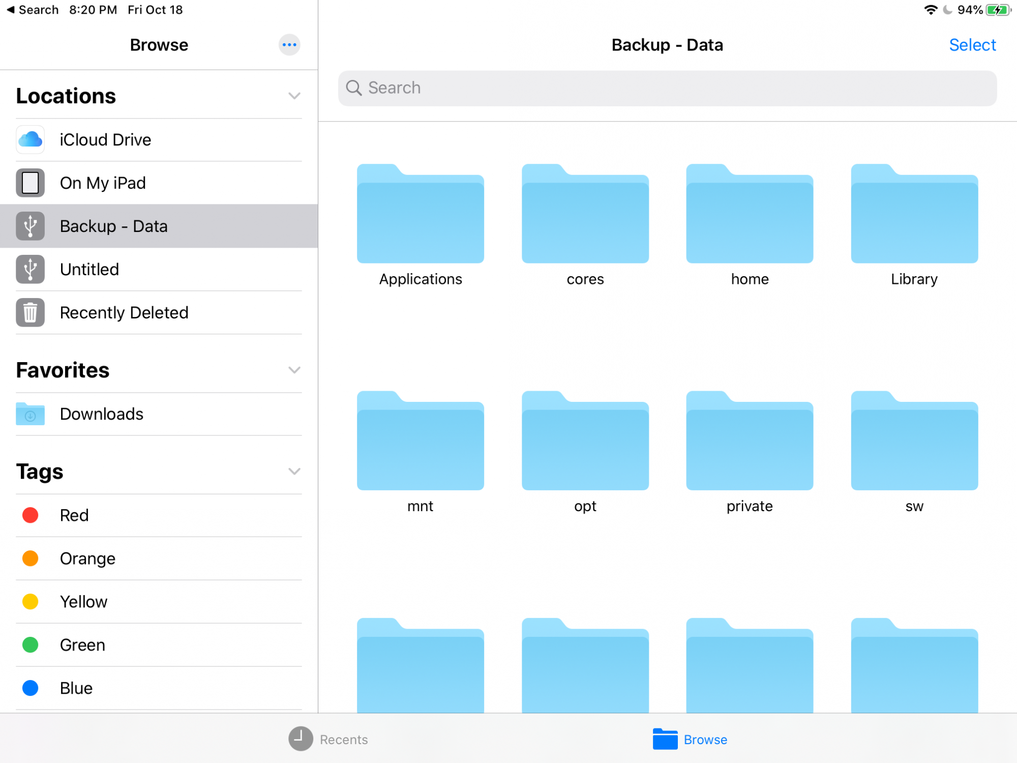

I also just tried that Samsung SSD on my kid's iPad Air 2. It works:
