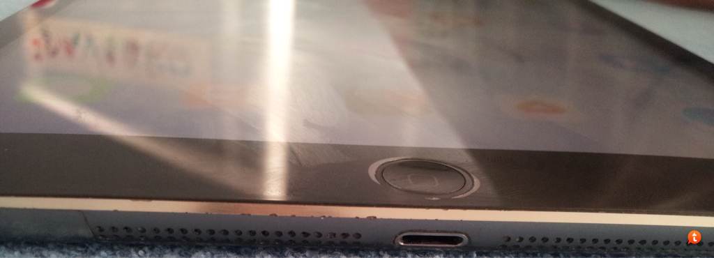

Did you ever seen scuffed edge / bezel of iPad Air? Is there any spray or paint for this, or is some way to hide it?
This is how it looks:
Thanks.
P.S.: I think that iPad mini and iPhone 5S have the same bezel...
It's bare aluminium so if your confident you could file it or sand and polish it up again.
While your at it I would try dig some dirt out your speaker holes 😉
Okay, I'll try to deal with it... And that is my another question... How can I perfectly clean my speakers? Its not as loud as new... I tried vacuum cleaner and it didnt help. So I tried toothpick and it cleaned just about 30% of dirt (30% louder audio)... Any suggestions?
There is a product available designed to be pressed between keyboards to pull all the dirt out, it's like a kind of stretchy putty.
Or, turn your iPad completely off and use isopropyl alcohol and a microfiber cloth, the alcohol should loosen the dirt and fall out without the cloth as you don't want any pushed inside, maybe Hoover it just after having applied the alcohol.
#0000 very fine steel wool works magic on aluminum bezels like this. Use it lightly and sparingly. I've buffed many iPhone bezels back to new using it.
