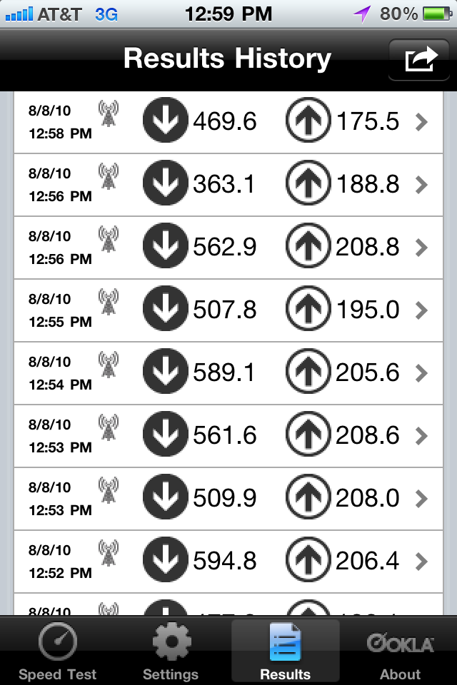

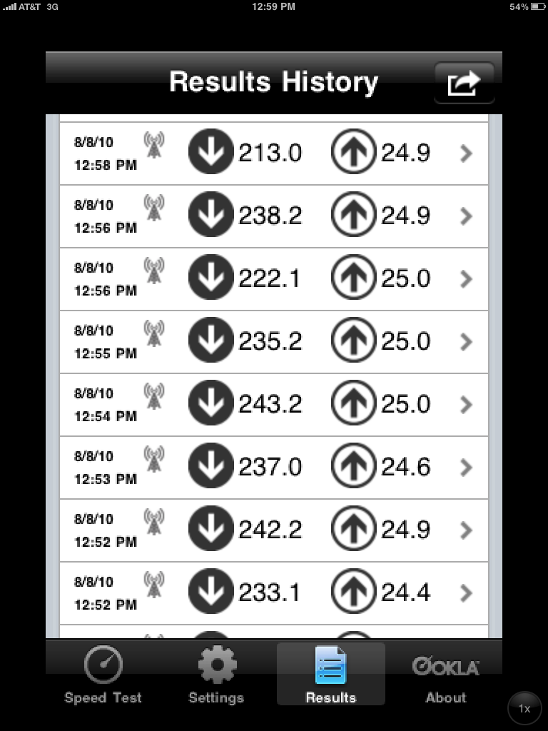

Hello, I ran some 3G benchmarks on my iPad and iPhone 4 and consistently saw that the iPhone got upload speeds approximately 10X better than my iPad 3G. With the exception of the topmost test (12:58), these tests were performed in an alternating fashion, such that first Id run an iPhone test, then an iPad test. These tests were performed at my home, which has a cell tower on my roof.
The topmost benchmark i started both tests simultaneously to see if there was any competition for bandwidth, but it appears minimal.
So, is AT&T throttling 3G service on the iPad or is the antenna/chipset on the iPhone ~10X better on upload speeds?
Results are in kiloBytes/sec.

I tried it. It's very easy to do actually. Just place the iPhone 4 sim in the iPad, power it up and change the APN settings to phone instead of broadband.
There was no change in download/upload speed, so the only safe assumption is that the iPad's 3G antenna/chipset is nowhere near as good as the iPhone 4 antenna/chipset. That would be for both upload and download speeds.
I ran the same benchmarks for wifi and the iPad's wifi antenna/chipset gets better download speed about 1.8MBytes/sec on iPad compared to 1.3MBytes on the iPhone 4.
The 3G chips inside the iPad are the same as the 3GS not the iphone4. You'll always see slower upload speeds. If you were testing along side a 3GS then you would get comparable results
Download 3G speed is ~2X better on an iPhone 4 than on the iPad 3G. Upload speed is ~10X better on an iPhone 4 than on an iPad 3G.
I get an average of download/upload speeds ~ 2.5Mbps/1Mbps for an iPhone 4, compared to download/upload speeds of ~1.5Mbps/0.20Mbps for my iPad 3G.

But the iPhone 4 does have HSUPA which is fasted than the iPad at uploading.
Is HSUPA also responsible for the 2X better performance for download speed as well?

Plus towers can apparently be misconfigured. I get 58kb/s upload speed on my iPad at work, and I can get over 1mb/sec upload on my iPhone 4 at the same time in the same place. Go home, and the iPad jumps to 200kb/sec upload.
