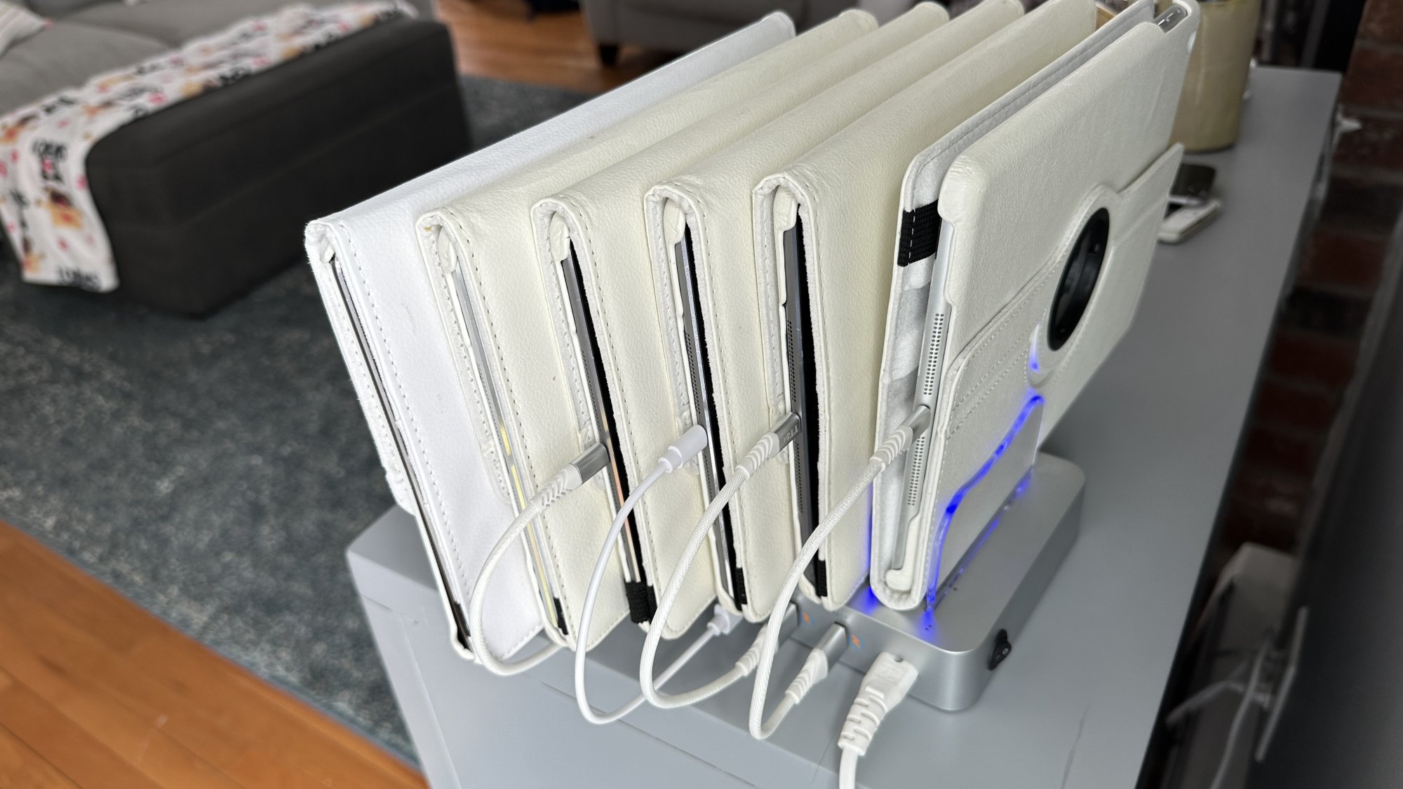

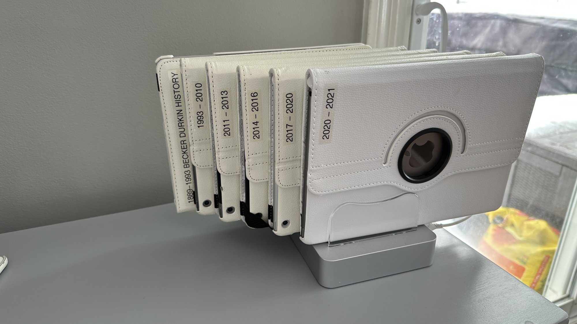

Hi Everyone,
I have my iPads set up as separate photo albums by year. ( see pictures). I like to keep them plugged in all the time so people can come browse, but mostly they sit on the shelf unused, sometimes for months at a time.
After a couple of years, the batteries are dead or go from 100% to 0 in like 5 minutes. Are there gadgets, tools, techniques, that I could use to help? I can replace the battery and or ipads, but I imagine I will just run into this again. I'm open to ideas or maybe a different approach all together?
I know, they are not suppose to be left plug in. So what ideas do people have? How can I have these sitting un used the majority of the time, but ready to enjoy at a moments notice? It might be months in between use.
Maybe there is a gadget, tool, or software that addresses this?
Thanks!

Purchase a HomeKit compatible electric socket, plug it between the wall and the charging station's power plug. Automate the socket to occasionally turn on for awhile, then turn off again (for example once a week for one hour - depends on how much use the iPads get). You'll need a dedicated iPad or Apple TV on the Wi-Fi network to run the automation.
Make sure to test that the iPads are actually charging when the plug is on. Some plugs and devices don't work well together.

Brilliant. I had not thought about an automated on-off switch to simulate usage, drain and recharging. I will put this on my list of possible solutions! Thank you Puonti!
