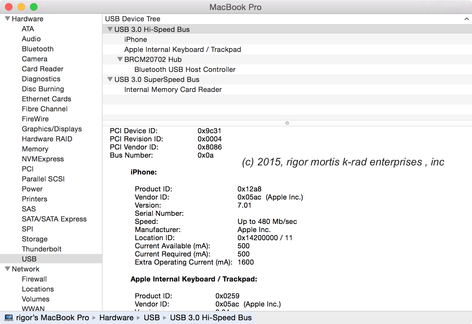

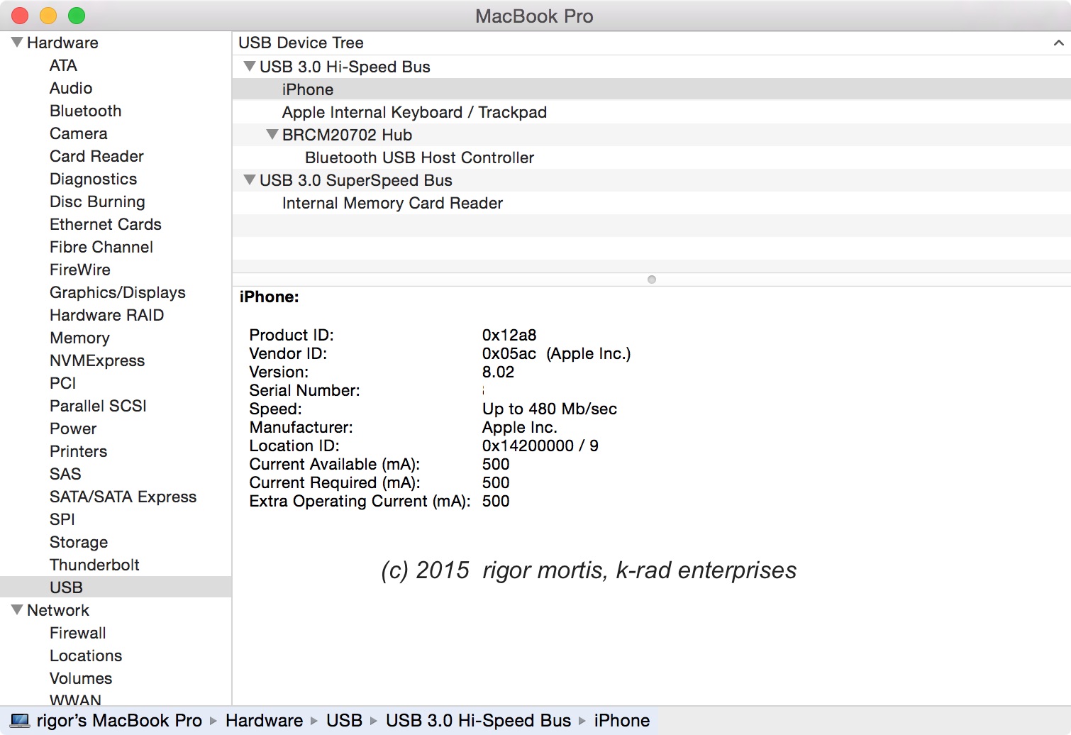

here are my screen shots
6+
6+s
6+
6+s

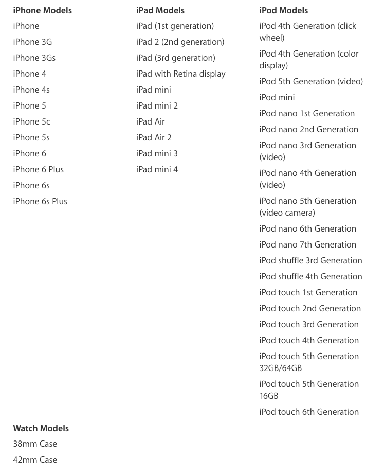

The 12W can be used with these products:
Basically all phones, all ipads, all ipods and all watches.
(screen is from the apple sales page)
Reactions: Mivo

i did not mean to imply the phone would be damaged. the iPhone cant be damaged by the ipad charger because it HAS TO ASK for what current it wants.
it tells the ipad charger , hey give me iPod 4th gen current and the ipad charger says OK here you go

the old iPhone 6 and 6+ fully supported the ipad charging current of 5 v @ 2100 ma, the new ones DO NOT

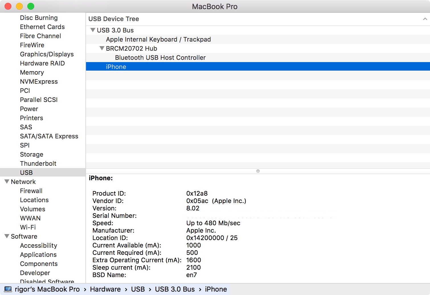

okay. i researched this issue more
we need to call apple care and ask them whats going on???
however. the posts have been changed to:
If you want to charge your iPhone 6s or 6+s at full ipad current using your mac, you must upgrade to El Capitan
if you continue to use Yosemite, you will only get 1000 ma current
if you need a software update to get fast charging on your mac, do you need your charger updated???? does the old 12 watt chargers know about the new iPhones??? do they need a firmware update???
here is what the mac book pro late 2013 says once it has been updated to El Capitan.
a mac mini 2010 model running el Capitan says
current available 1000
required 500
extra 500
sleep 1000

this needs more research. but i found out the charging current was limited because i was running Yosemite.
an upgrade to El Capitan is required to enable fast charging
