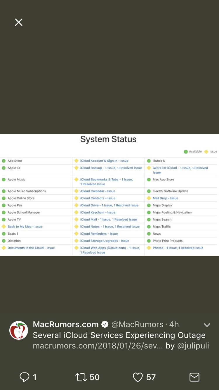

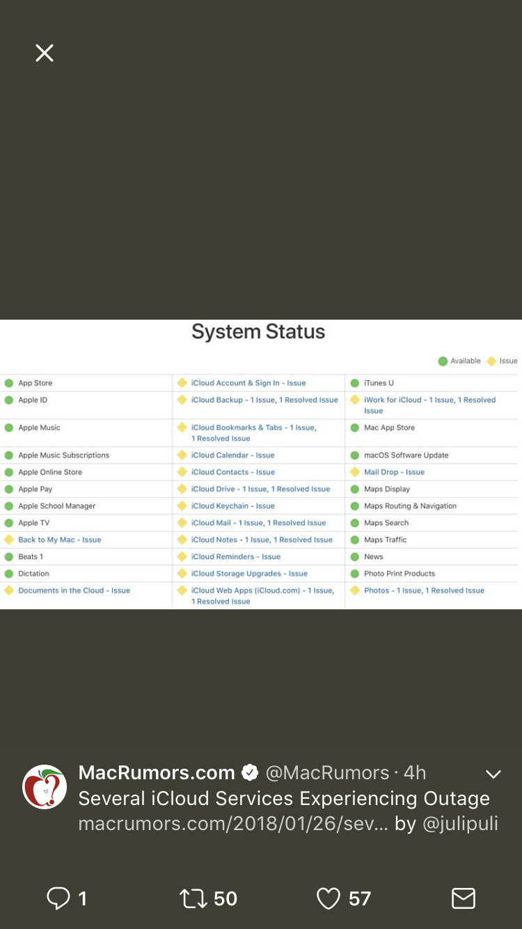

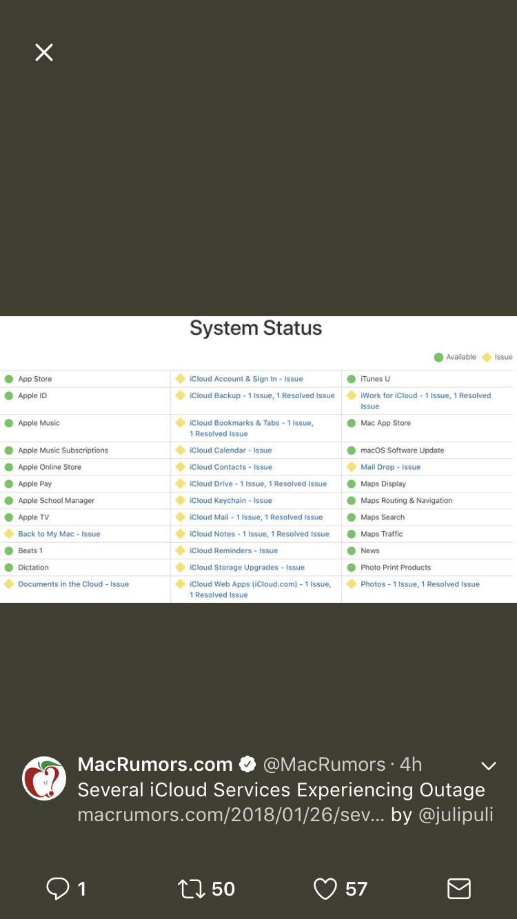

As you can see, Apple has some problem issue with all iCloud service yesterday. And I had some problem with you two where I can't log in to any iCloud service yesterday in my iPad mini 2 with 11.3 Public Beta (Before I reset all setting and content). Try to Reset all setting and Content on your iPad with 11.3 Public Beta to fix them back to normal. Cheers!
