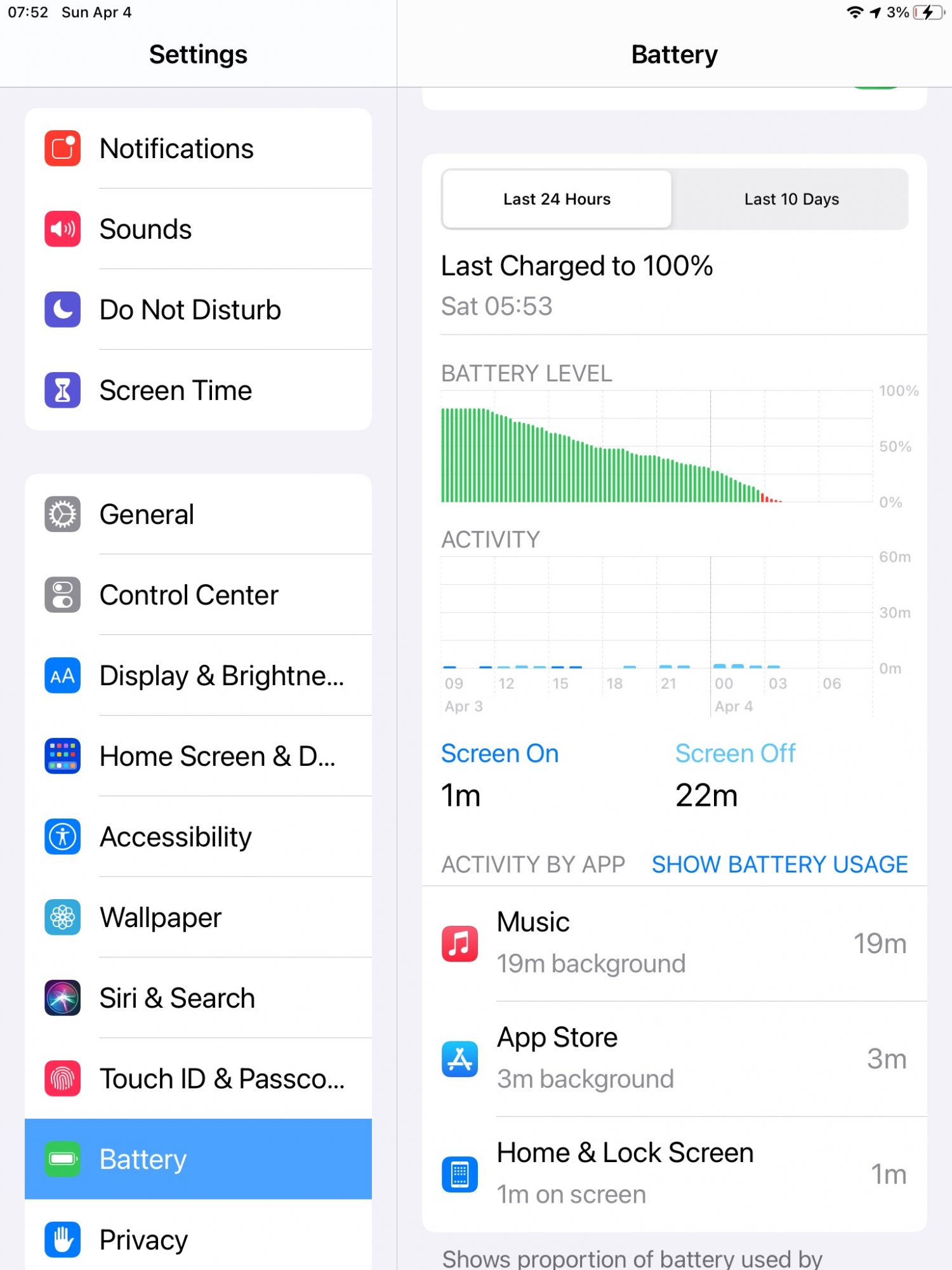

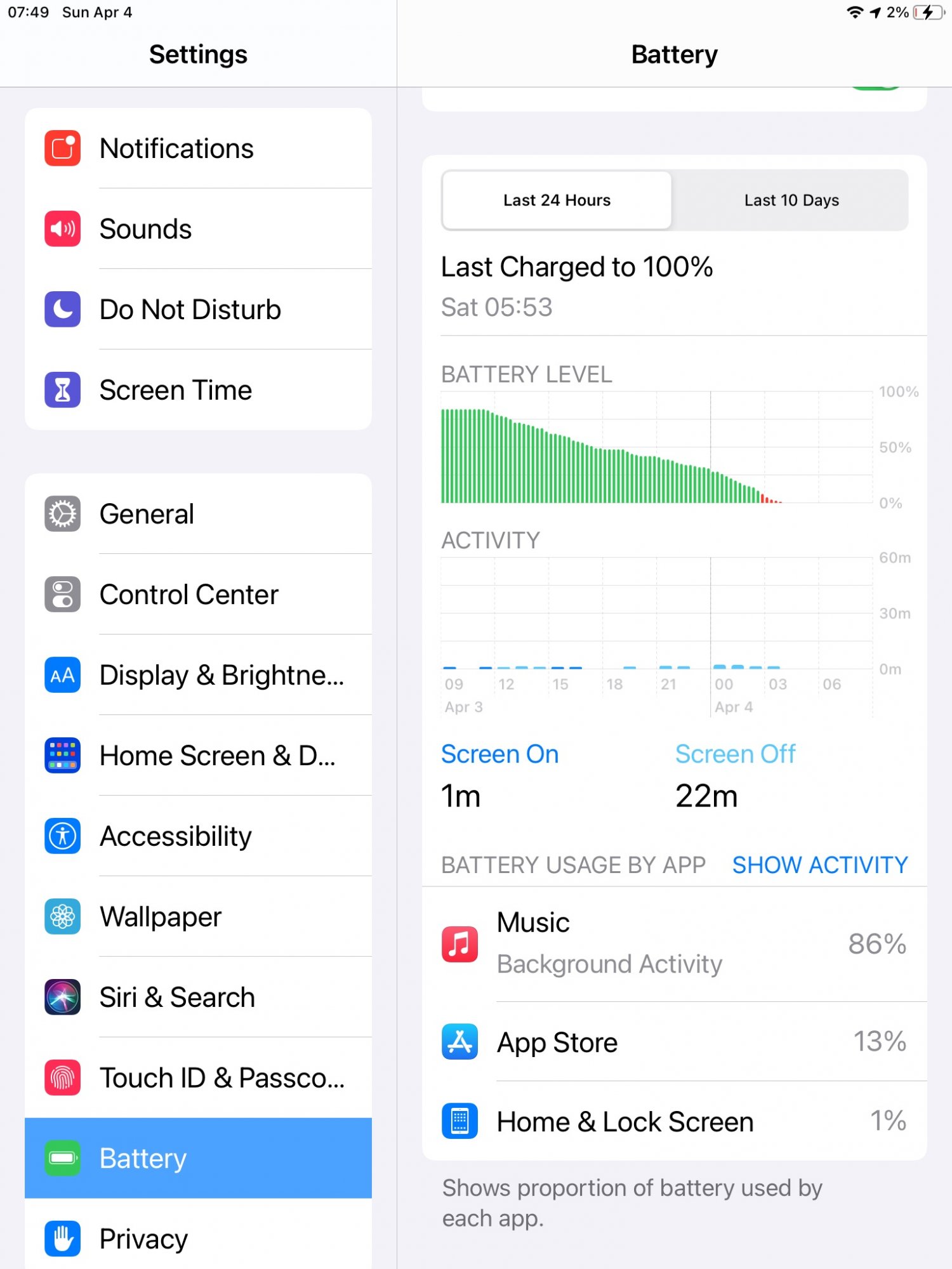

As stated above I did a reboot of the iPad at 6:00 AM yesterday, unlocked it and set it aside. I didn't use it all day/night. So, the screen was off all the time except for when I logged in. No apps were running. When I checked it this morning at 7:30 AM, the battery was completely dead. After I charged it enough to start it up, I checked Battery and took a couple of screenshots. Oddly it shows Music as being played for 19 minutes. I never, ever play music with my iPad and certainly music was not playing when it was sitting unused on my desk overnight.
Any thoughts?
CE309954-CECB-459B-8957-BEF56D544C83_1_101_o.jpeg1E1EF9C2-D35E-4759-8E2C-20C337FA1097_1_101_o.jpeg

I did what you suggested. Any reaction to the results?
Odd behavior from Music app and not sure why. Is it up to date?
I too do not use Music app and it does not show up at all on my activity/usage statistics even for the last 10 days on my iPad Pro. Do you have an Apple Music library? If you don't use it on the iPad perhaps go into settings for Music app and just turn off library sync as a test. Not sure what else to suggest - these things can sometimes be a process of elimination thing.

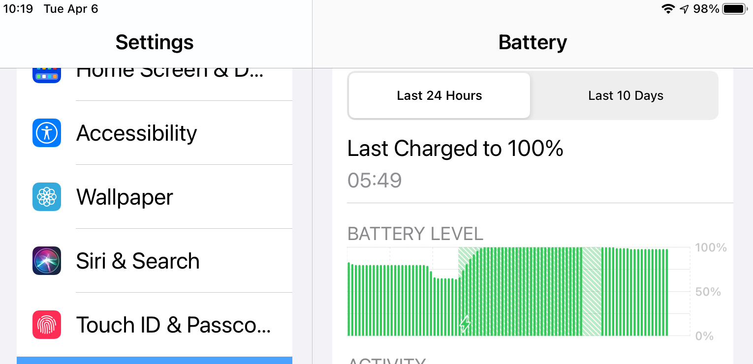

Yesterday I was otherwise engaged so didn't get a chance to use my iPad as usual. But, I did notice that there seemed to be much less battery drain than before I let the battery completely drain and the iPad shut down.
This morning I checked the iPad just before 6:00 AM. It was at 100% so I removed it from the charger, force rebooted it, logged in and set it aside. When I was ready to read the newspaper, just after 10:00 AM, I was pleased to see that in over four idle hours, the battery had only gone down to 98%. This is a major improvement over what I have been experiencing for the past few months.

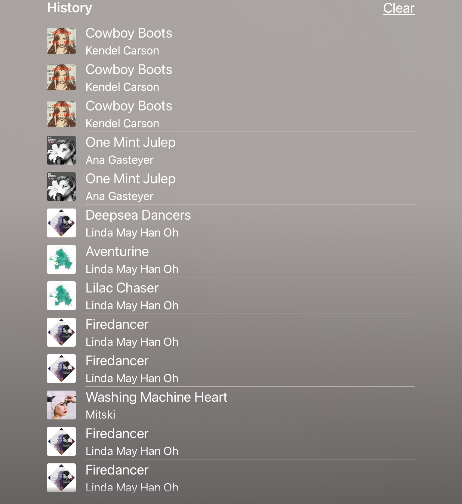

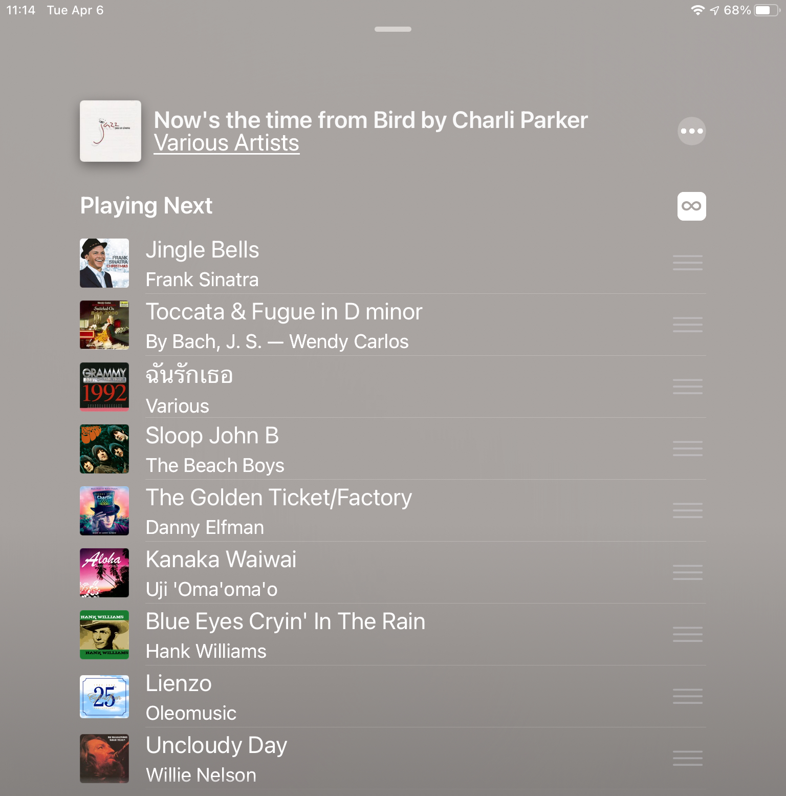

When I got to the coffee shop where I planned to read the newspaper I popped in my AirPods first thing. I was so surprised that music immediately started playing. I looked at my Apple Watch but it said "Not Playing" for both the watch and my iPhone. I checked the iPod and sure enough, it had started playing a piece by Charli Parker. Odd, because I don't normally listen to jazz in the morning. I checked the play history on the iPad and was very surprised to see a list of songs I mostly don't know by artists, some of whom I've never heard of.
I have no idea where this weird playlist came from or why my iPad started playing it. (I would have thought that if the iPad were playing music before I put on the AirPods I would have heard it from the iPad speakers. There was nothing.)
Frank Sinatra singing "Jingle Bells"? Well, maybe, but not in April.
I stopped Music, read the "Bangkok Post" and drank my cappuccino. That took about an hour. At the end of that hour the iPad was down to 67% battery. That's more in line with what I've been experiencing lately.
Such an eclectic and strange collection of songs with these weird repeats.
