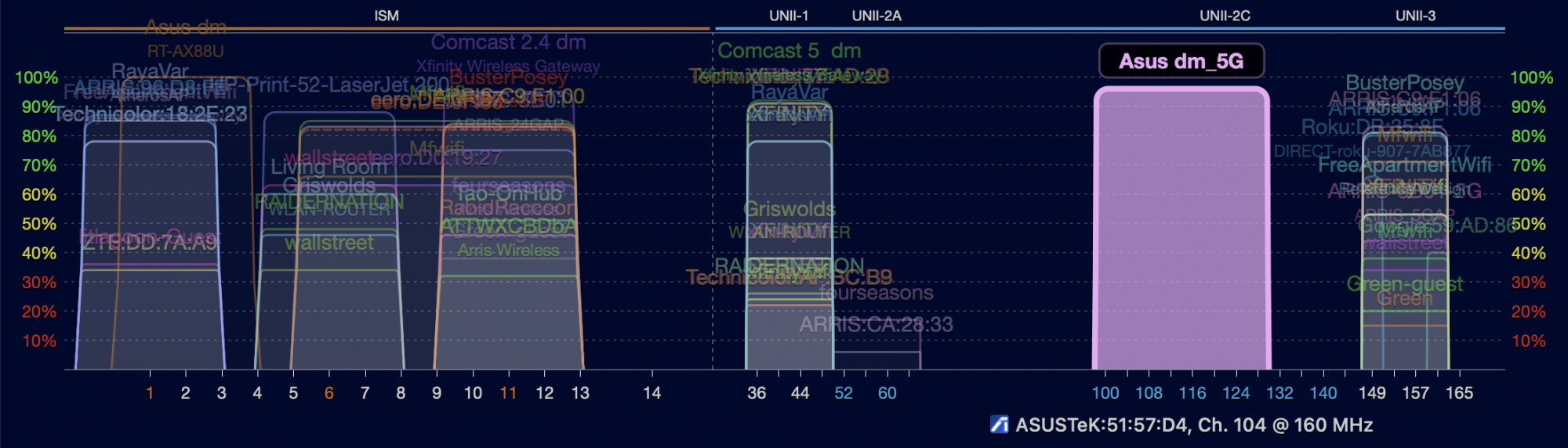

Interesting about the iPhone connect failure as it was looking a bit like it was an issue connecting with mesh networks.
I have found WiFi explorer to be a great tool helping to decide which channel to use:
With 86 networks contending for channels I set my router to use channels that no one else is using.
Linksys Velop in Bridged mode does not allow me to modify channels, so I'm out of luck as well.
