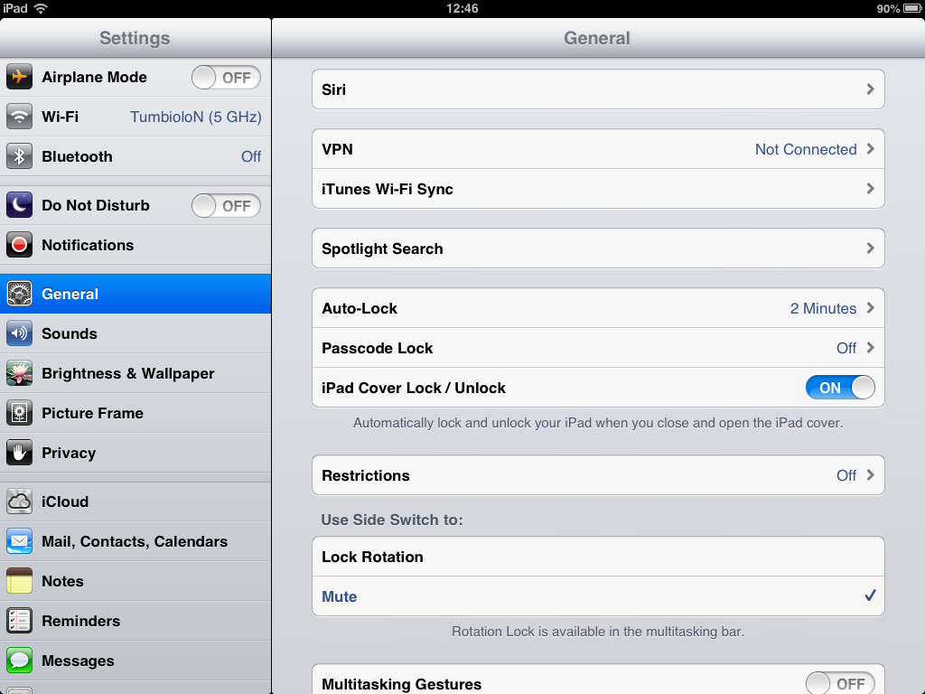

The lock/unlock function option is there , I just had a look..but I'm on 6.0.1 and have no idea if it was there before the update or not 😕
Where is it? It is not in General setting like my iPad 3 in the auto lock area? I have 6.01 installed on my iPad Mini white 32 GB. Should I call Apple?
6.0.1 on a Black 16 GB mini here, and the options is under General, then is the third (last) option in the grouping with Auto-Lock and Passcode Lock:

Like many people, i also do not have this point.
I have a third point called 'Restrictions' instead.
Very strange.
Very strange.
Same Here, mine has restrictions instead as the third line. Actually it is my daughters. If you restore, will she have to reload?
I did a restore and no change in the settings. It still doesn't have the iPad Cover lock/unlock setting. I don't have a smart cover yet. Anyone one that has this just a restriction setting and no the cover setting. If you have a Smart cover, see if that will activate setting. I am on the phone with Apple right now, and they haven't heard of this problem yet.

OK i got it.
I just used the Smart cover from an iPad 2, and then it appeared in system menu.

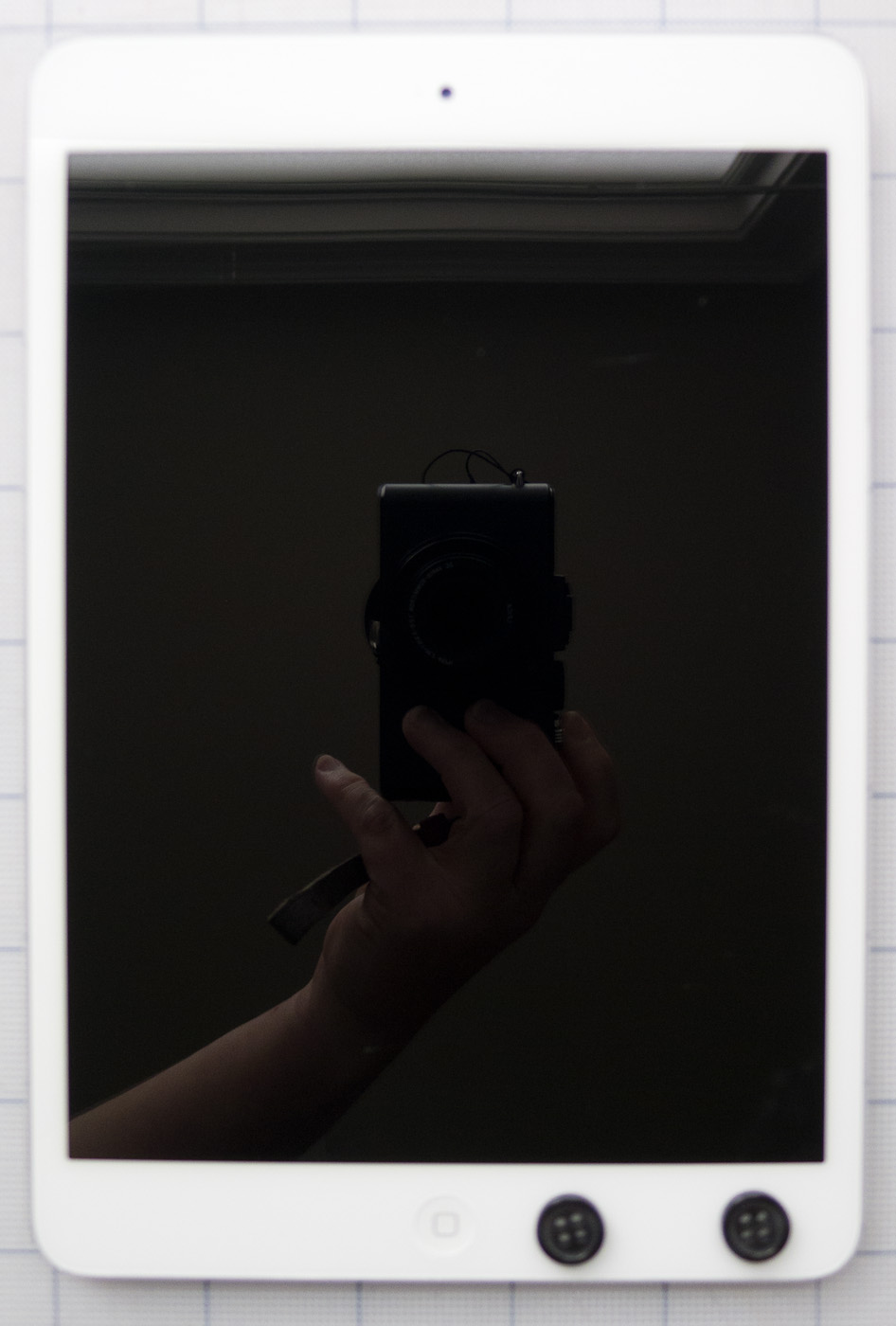

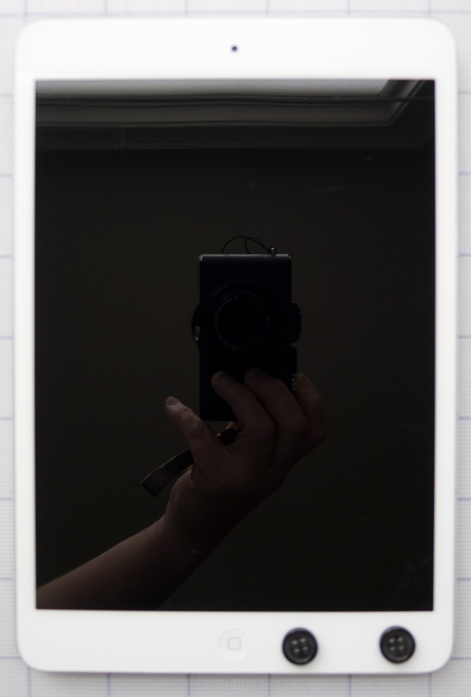

With two flat magnets (one next to home button and one in bottom right hand corner) it triggers the display to turn on or off. Polarity is also important.
photo of magnet locations
Thanks everybody for this thread, was able to start new case design after finding the tips posted here.
In gratitude, post my findings: The thin, weak-ish flexible and sheet magnets that worked for the original iPad cases do not appear to work for the mini. The mini seems to require small strong magnets.
Enclosing a photo with magnet locations that work. There may be other locations, but putting magnets in these 2 spots makes the case work reliably.

That works!
Ain't that some ****! I read all the posts then looked to see where the magnets were located on my iPad mini. I have a Brookstone case (not cheap either). The magnets are located on the bottom right and the top right of the case. When I placed two strong magnets, one to the right of the home button and one on the bottom right corner, the damn thing locked! I haven't used my mini in months because every time I open the case it's dead. Apple and their proprietary trickery make me crazy! I'm just glad the mystery is solved. Now.....to buy a new case or rig this one?
