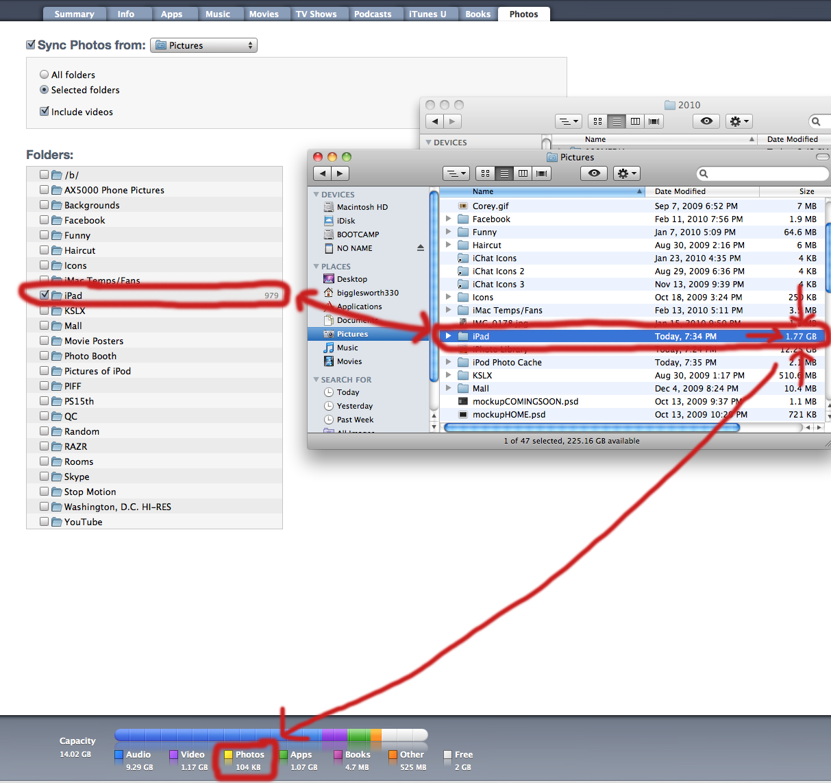

I'm trying to sync a bunch of photos to my iPad, and when I do that it doesn't actually sync any over, even though it says it did. At first I thought it was just iPhoto doing that, so I copied all 1.77GB of the photos to a folder and synced it that way. However, they still don't show up even though it says the sync was complete. Also, when I try to sync another album it syncs all the photos but not the videos, even though "Sync videos" is checked. Why is this happening? To better explain it I attached a screenshot.

You don't have enough free space. Yes, I know it shows 2GB free and you are only trying to sync 1.77GB. But, unfortunately, that's how it works sometimes. The same thing happens with my iPhone.
If you pull enough photos out of the folder to get it down to about 1.5GB or so, I bet it will sync.

Thanks, that worked. Only problem now is, the videos still aren't syncing, even though the sync videos option is checked. Why is that? They're in .3gp format, if it matters.
