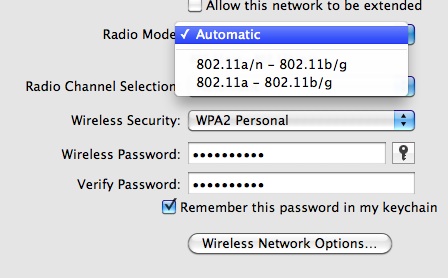

So how do I find out how my devices are connected (g or n) and how can I force them to g?
I've turned off 5GHz mode so my MBP is connecting n @ 2.4GHz (Option-click the Airport icon in the menu bar).
My AEBS has the following modes...
which doesn't make much sense to me, and the Help isn't much help either..
Set the radio mode to 802.11n (802.11b/g compatible), 802.11n only (2.4GHz), 802.11n (802.11a compatible), or 802.11n only (5GHz), depending on your base station and the client computers that will join your network.

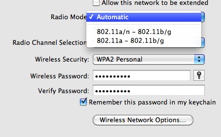

Just select the 802.11a / 802.11b/g mode .. that should force you to G-mode only at 54Mbps.
Also, I haven't had any issues with my iPad and 802.11a/n modes.
