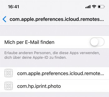

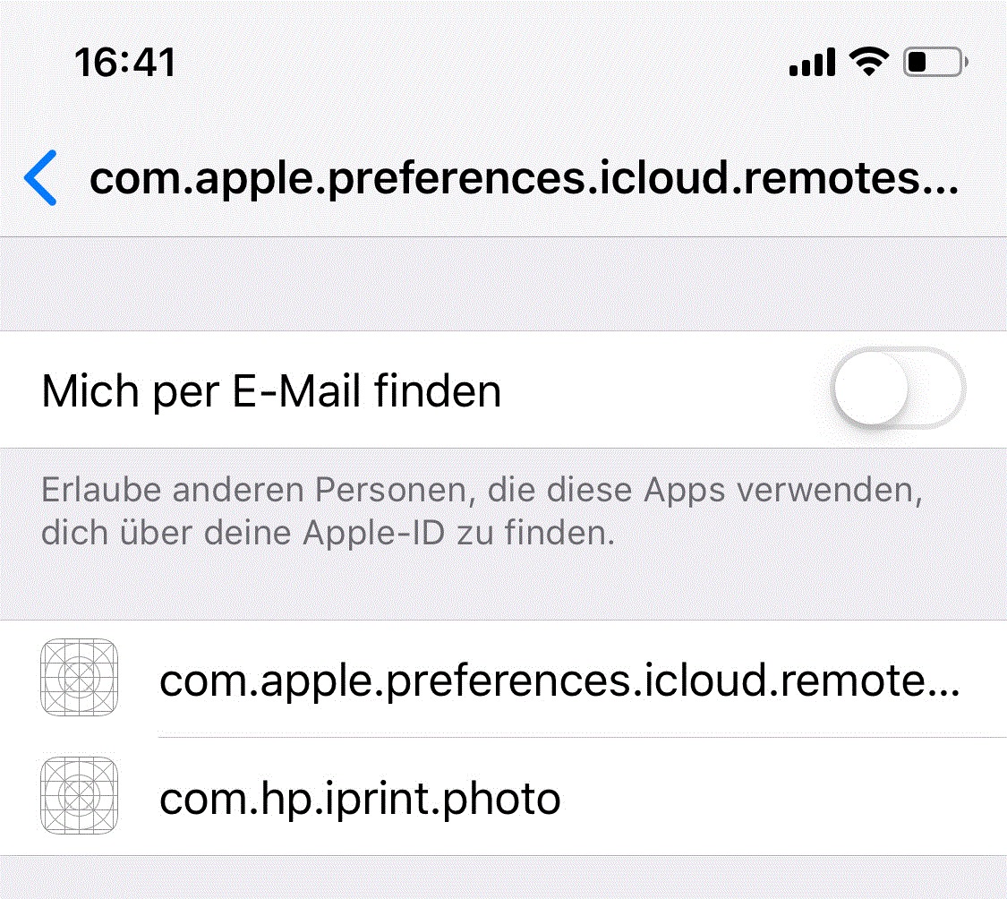

Seems like I have with my iCloud account a similar issue but with my iPhone X.
Draining battery also over night etc and also high battery drain like you mentioned on your iPad Pro.
Did you have settings like these here too? I have a screenshot of some settings that are in my iCloud account that are under the find me via email setting
Hope I can fix the stuff with battery like you did with enable disable sync. Maybe in my case it can be contact or so.
I will delete all data on iCloud and put it manually in.
