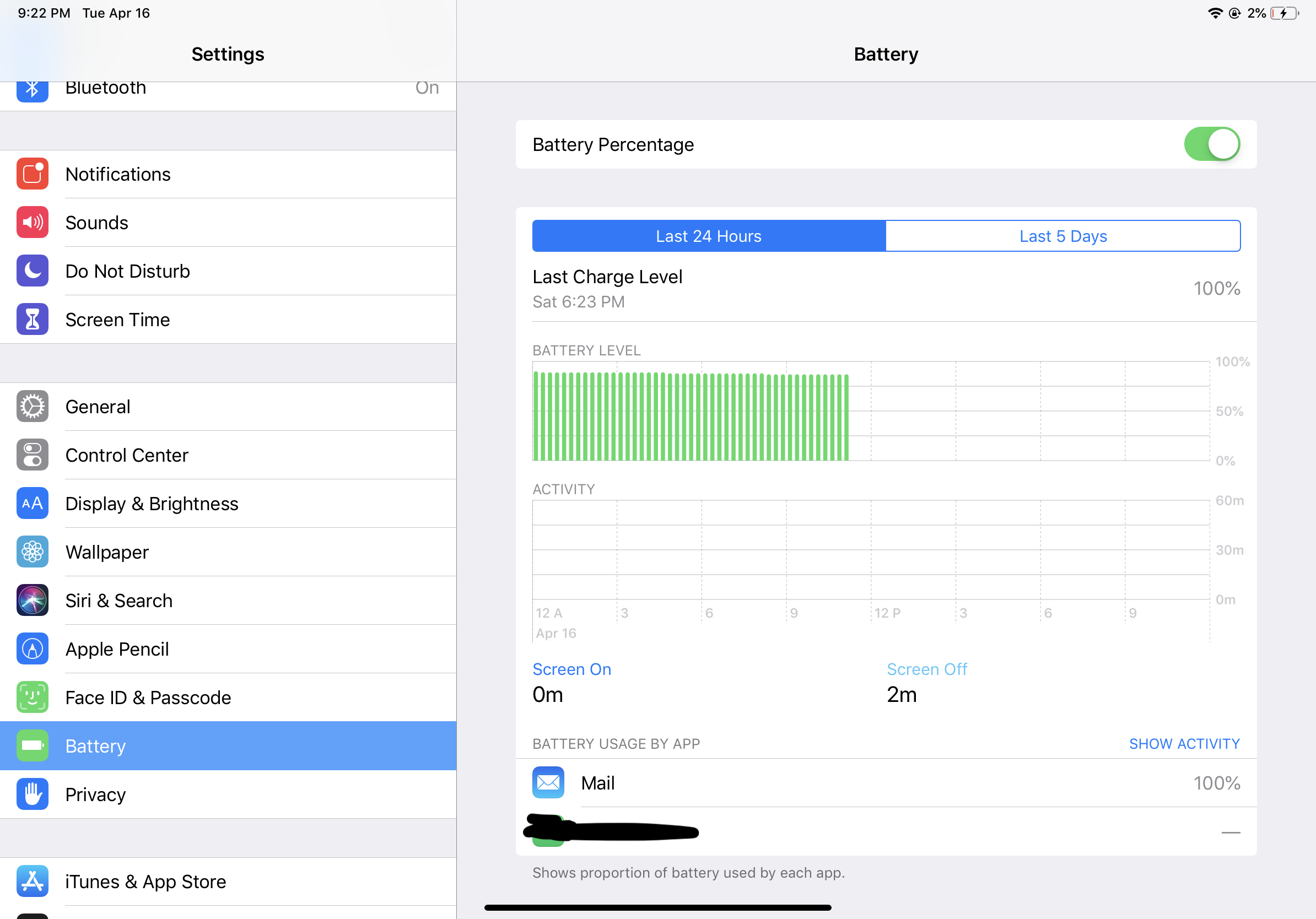

I charged my iPad pro full on Saturday. Left it sitting there until now - Tuesday.
The battery is completed depleted. What could have happened?
The battery drain chart is so strange...
Fetch is set to automatic, same as my other iPads. never seem this behavior. It seems that the battery suddenly drained off ...
