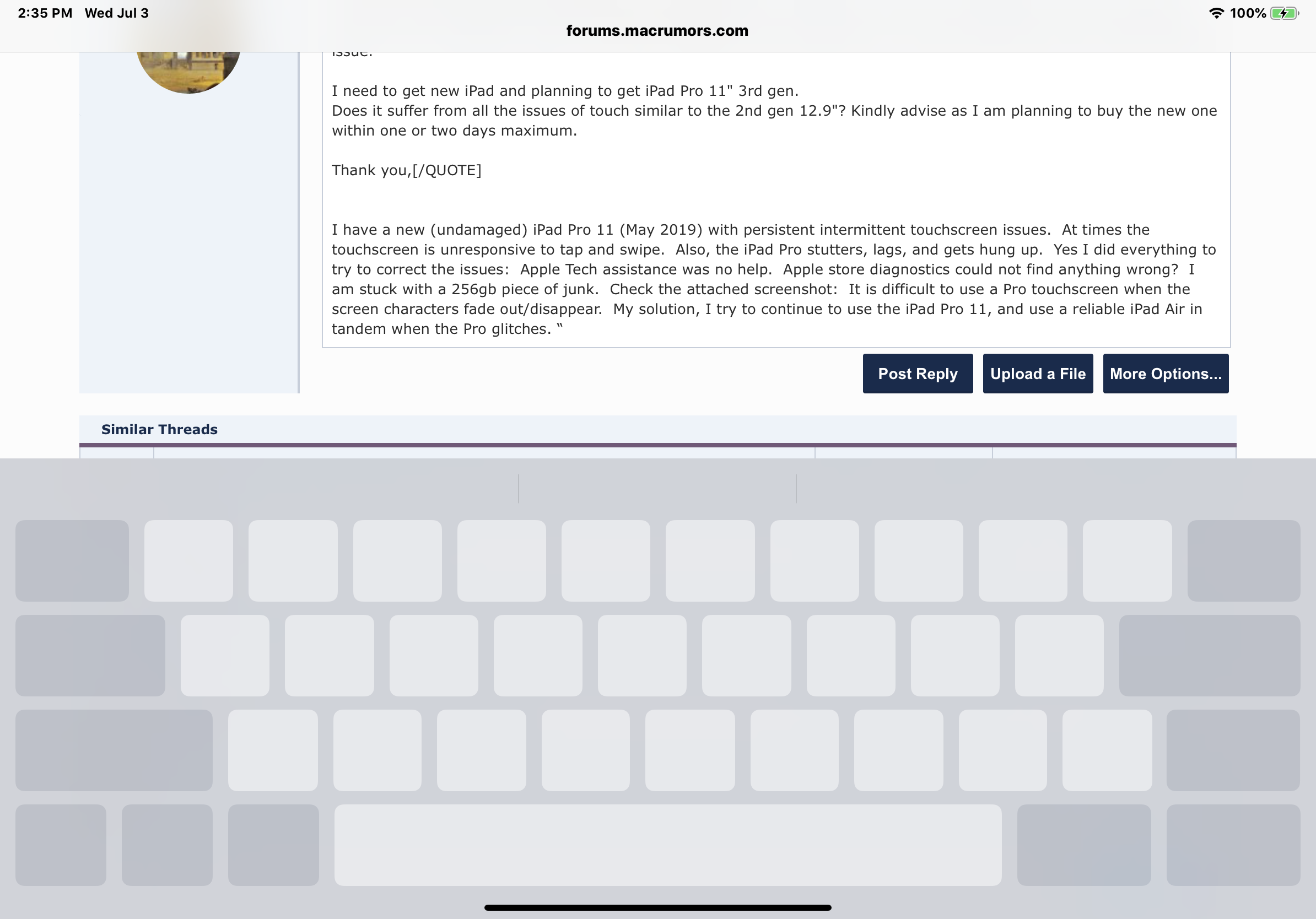

I have a new iPad Pro 11 with similar touchscreen issues that you demonstrate in your video. My touchscreen is intermittently unresponsive to tap and swipe. Also the characters on my touchscreen disappear... check this and more in my screenshot attachment:
