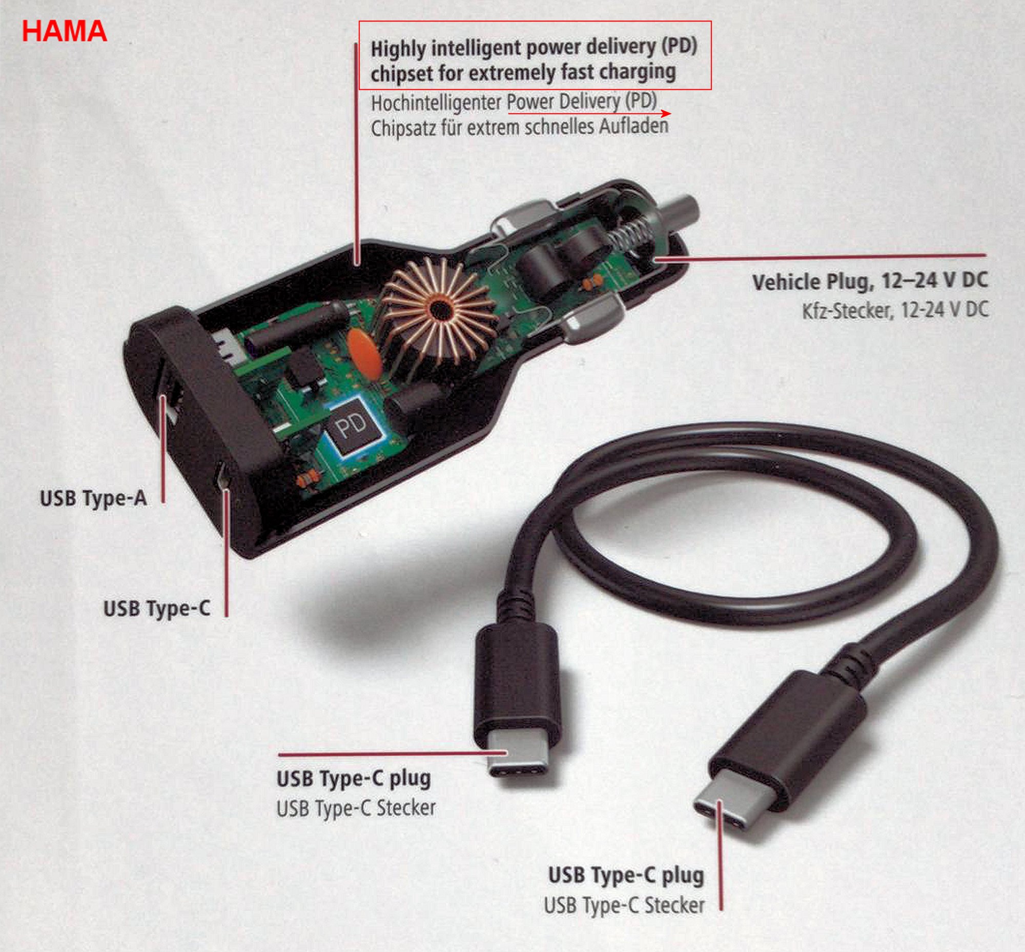

After spending my last Sunday to analyze the specs, I've found the way to revive my iPad from a 12v car charger..
You absolutely need to charge your iPad via a USB-C to USB-C power cable.
Do no try via a USB-A to USB-C, it will not work when you have only the empty battery on your display..
Due to missing wires in the USB-A connector, the charger cannot "talk" to the iPad and adjust the charging power.
You absolutely need a charger (car or wall charger) compatible with the "PD" standard,i.e Power Delivery Standard.
There are not many car chargers compatible with that specification.
Some have PD written on top of the USB-C port.
I've found the following brands compatible with the PD specification:
SBS car charger, Intertronic 230V wall charger, Hama car charger, PNY car charger.
Nintendo power charger.
The Hama car charger is the most expensive (50 euros), but it is supplied with the appropriate power USB-C cable.
This is the one I've bought because it was available on stock.
I've immediately connected the iPad Pro 11'' in my car and about 10 minutes later the iPad restarted.
Cool for my iPad.
