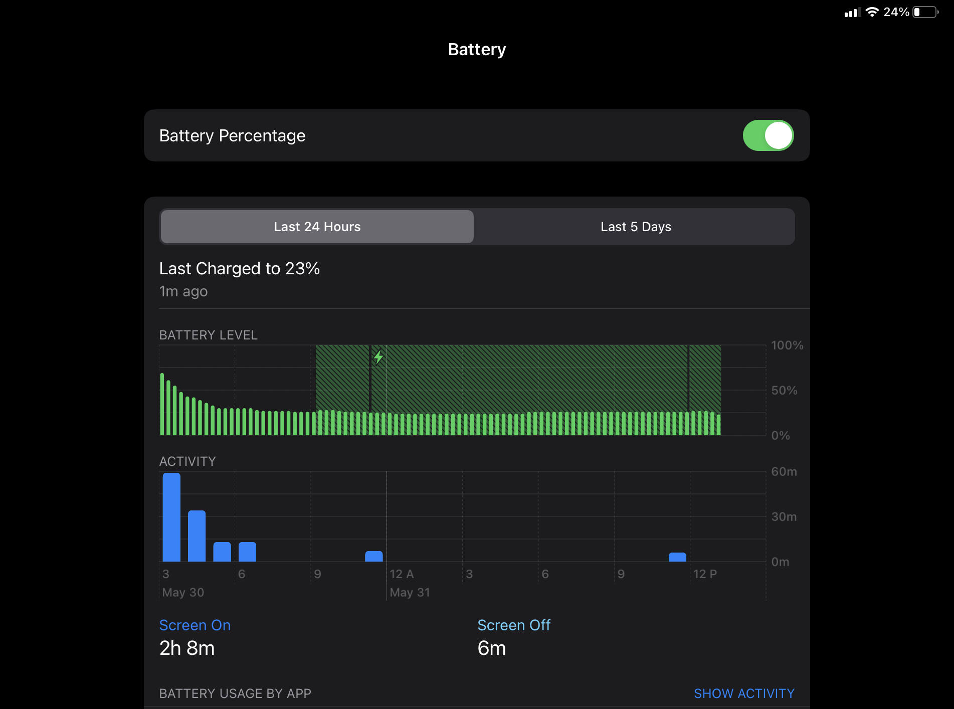

I am having the same issue. I put the iPad on the charger last night and this morning was at 24%. Thinking I must of not connected it right, reconnected it. Checked it 3 hours later and its at 24%. Checked the battery usage and its showing it was connected to the charger but did not charge.
Ill be contacting Apple today.
