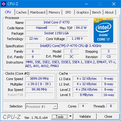

Are you guys sure this isn't due to the fact that by comparing a PC with this new IPP 9.7:
It's like comparing a regular car with a Ferrari?
This is what my iPAD 4 is...
Correct me if I am wrong, but I don't think there has been too much improvement in the hardware to handle these kinds of videos.
