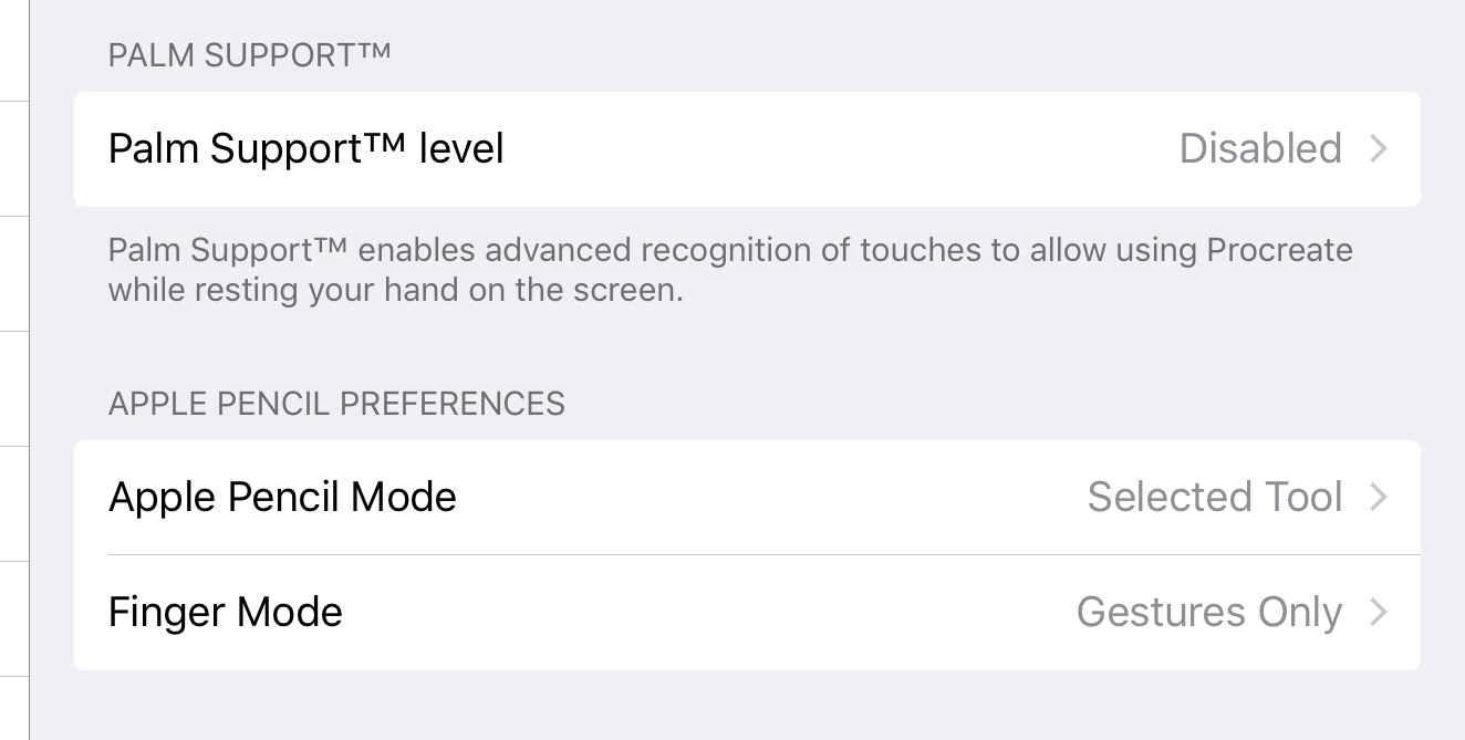

I've got Procreate setup so it's impossible to draw anything with my fingers (or hand). Look under the IOS Settings for the Procreate App. Procreate ignores everything except for my pencil.
Yes I have that setting also. The issue is that the screen moves all over, like video shows. Thanks for the idea though!
